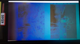

I have had two separate 120 rolls of Rollei CN200 come back from the same lab, but processed one week apart. Both have had 3-4 frames at the beginning of the roll with a strong blue tint. The blue extends to the edges of the film. It starts deep blue at the extreme start of the film and fades out over 4 frames. My frames are 645 ratio.
One of the films had a horizontal blue streak later in the roll.
The films are from different shops. A 120 roll of Kodak processed at the same time as the second film, has no problem.
I can post a photo later when i have access to my lightbox.

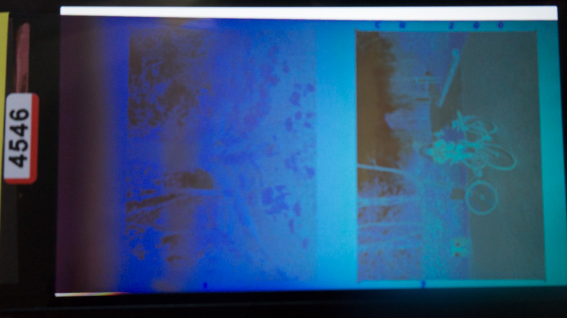

Thanks for comments
Please see pictures of one film. Is this light-piping or manufacturing fault?
I will check batch number tomorrow.
I loaded indoors away from bright light. Is that good enough?
Why is the blue only at one end?
Why does one film have blue streak across in the middle of film?
I will read Maco site page.

Mmmm.. that doesn't look like light piping that I have seen, it seems too broad but looks like light might have leaked in at some stage but hard to say at what point. I would contact Maco with the examples.

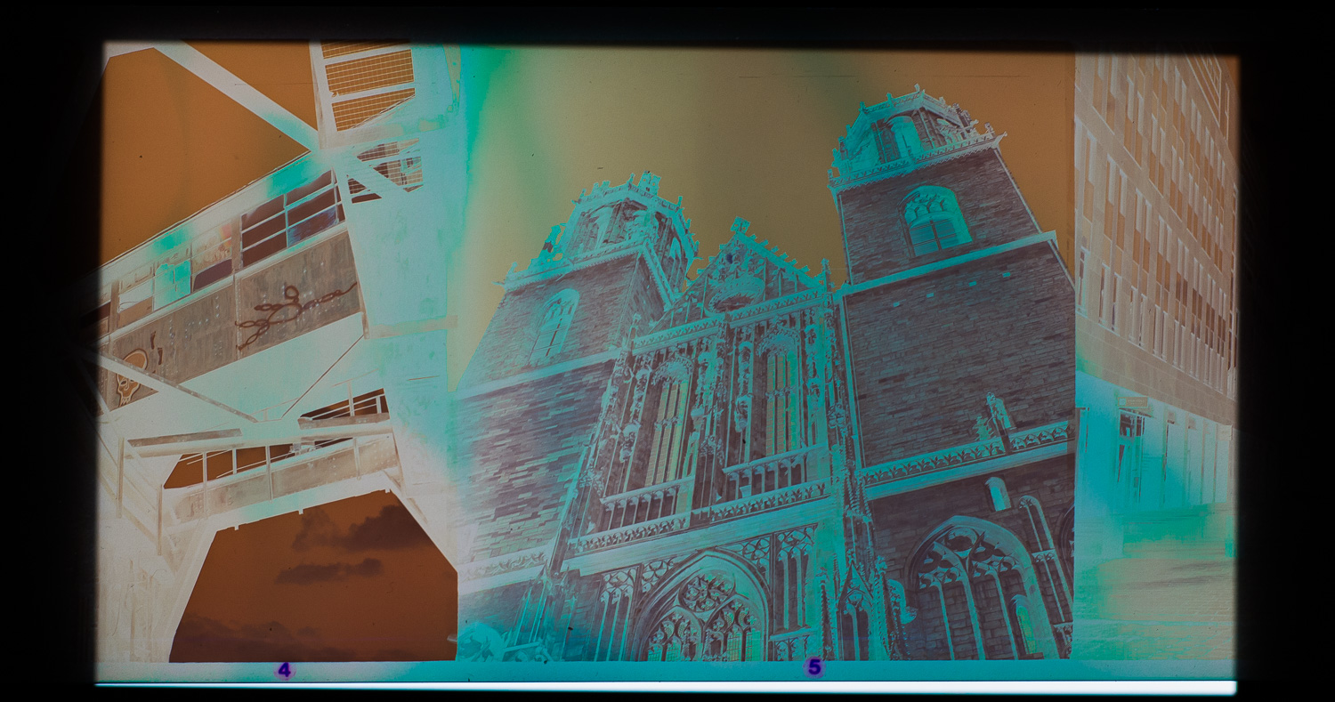

I have a very similiar problem with my Rollei CN 200 at the moment. My lab says it's light leaks due to camera problems, but they do not look like camera light leaks to me.
The overlap is a known feature of my camera. It tries to save film this way :wink: But the aquamarin / red clouds are a bit to "artistic" for my taste.

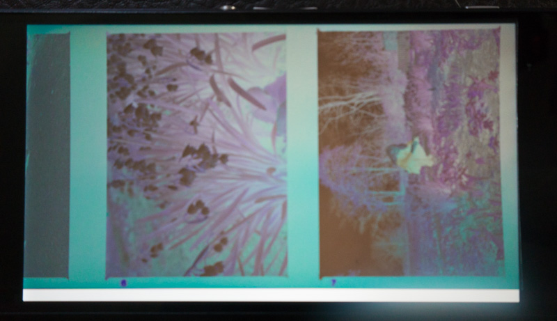

New roll, different camera, same story...
I am done with Rollei for now. Back to Ilford, Fuji, Fomapan and Kodak.

Looks like the start of the roll again going by those photos.
If so light piping more than likely.
Looks like it was lab processed. Is this the case? I find the whole film needs to be handled in total darkness, even a little leader exposed is enough to cause light piping with this stuff.
Don Promillo
Aug 14, 2015
31
Germany
Yes, processed by ORWO in Germany. Usually they do not destroy other C41 or slide film material.
I think it is a combination of film handling, bad luck and a film which has a leaky paper by default.
