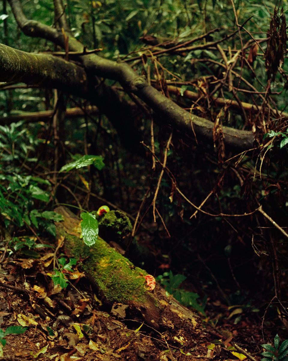

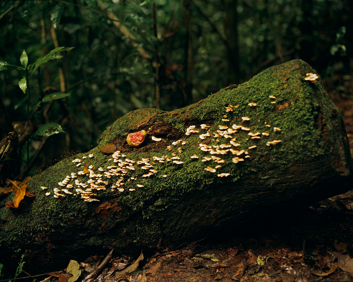

I've been using it lately, mostly to photograph still lifes . The manufacturing quality is pretty bad: the paper is a bit thinner than usual, and there's almost no glue to stick the end of the roll. The film itself is grainy and has very deep colors, especially greens and reds, which made me infatuated for it.
Here are some samples, taken with a pentax 6x7 and 105mm smc:
View attachment 88553 View attachment 88554
I'm actually impressed with the color here.
How much post adjustment was done? This almost looks like Velvia, also seems better than Ektar100 and how's the grain?
