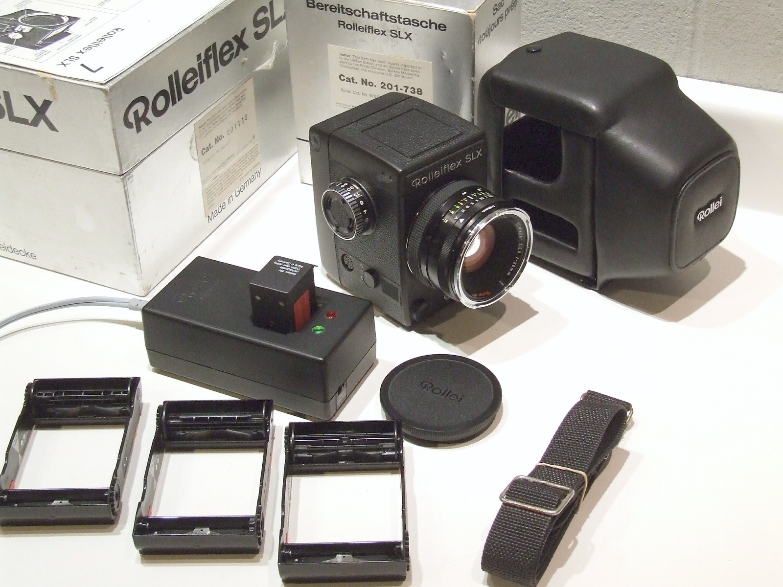

Very early SLX may have been unreliable, I don't know. I have never even seen one and you may never see on either. Especially if they were indeed unreliable you won't see one. My later 1970s SLX worked great for many, many years.
These very early ones have the sliver area on the right side around the on- off switch:

My first SLX ist the silver version. Then I bought another black (Generation II) one in a large set, which was quite a steal. I started looking for one just in case the original one would ever follow its reputation, however, the older one is more reliable. The newer has, what seems to be a known bug. It continuously draws current, emptying the battery eventually. This cannot be fixed. The good thing about the Rolleis is that the battery has no cover. You can just pull it out and push it in because they have no manual lock. The design locks when pushed in, and when pulling that tab at the bottom to get it out it is unlocked. It's as good as a main switch.
On my Gen I model I did shear off the power switch. A real stupidity on my side, although it is a slightly weak design. With strong force in a certain, unlikely direction you break it out. The camera still works, leaving the contact in the on position all the time. It makes no real difference. I have that ugly hole, however.
I read a comment from the early 90s in a German language news group: All the SLX still around have had the problem fixed by having been serviced. I.e. have their circuit boards exchanged. But I guess if you are unlucky enough to buy one that has always been owned by a private photographer that might not have happened. A working photography would have that money making tool fixed, whether Rollei did charge for that or not.
My newer SLX came from an estate sale, according to the eBay description. I'd wager on a well off physician or lawyer or similar. Lots of accessories, but only the 80mm lens. There is a teleconverter instead.

Sometime around 1988 I broke the preview button on my SLX, just in front of the on-off switch. When getting that fixed they did upgraded the circuit board. That SLX was still functioning perfectly when I traded it in on the 6008i. I hope it is out there being used still.
