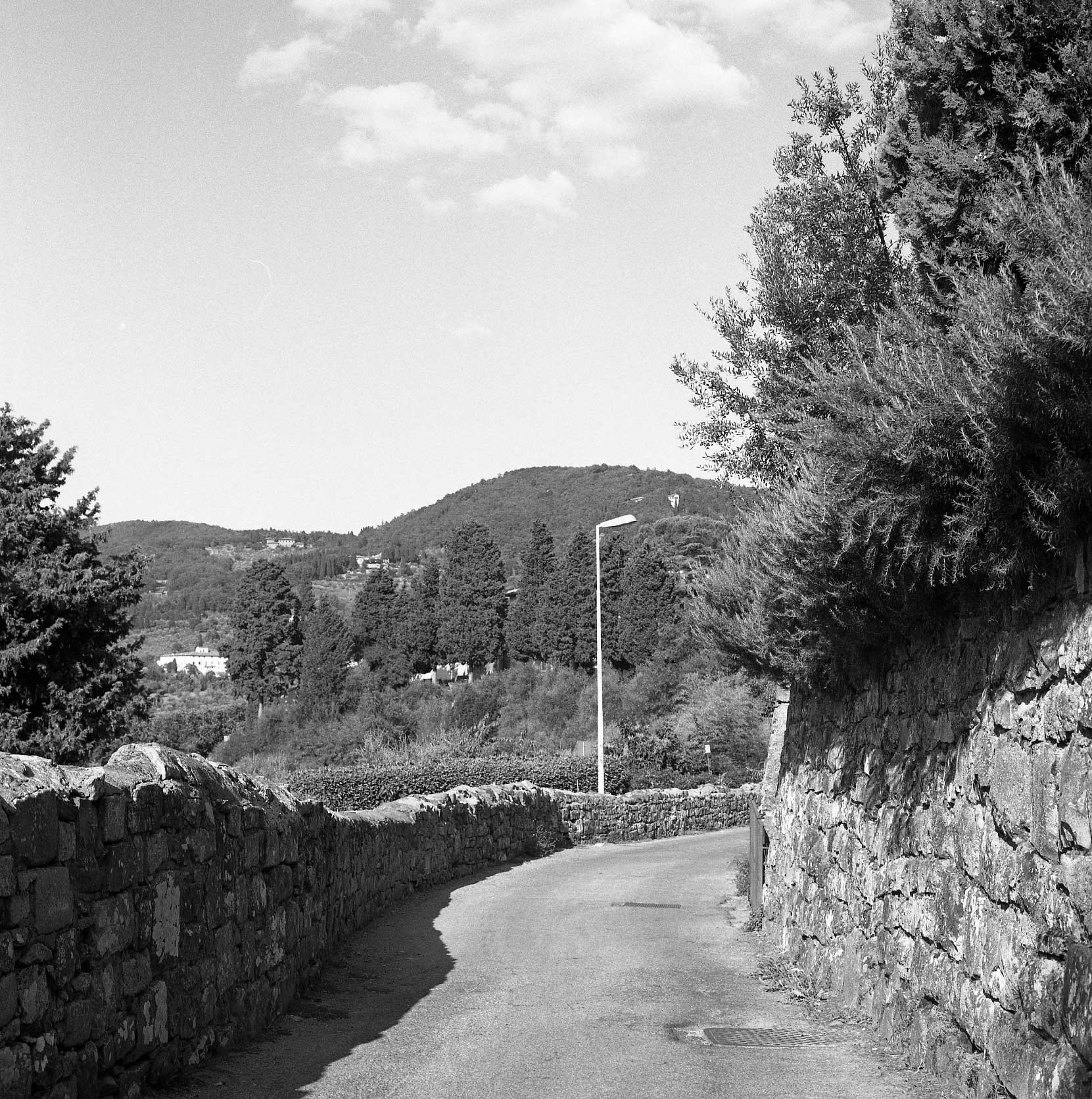

yesterday evening pictures: just to show you that NOW everything is ok...:whistling:
