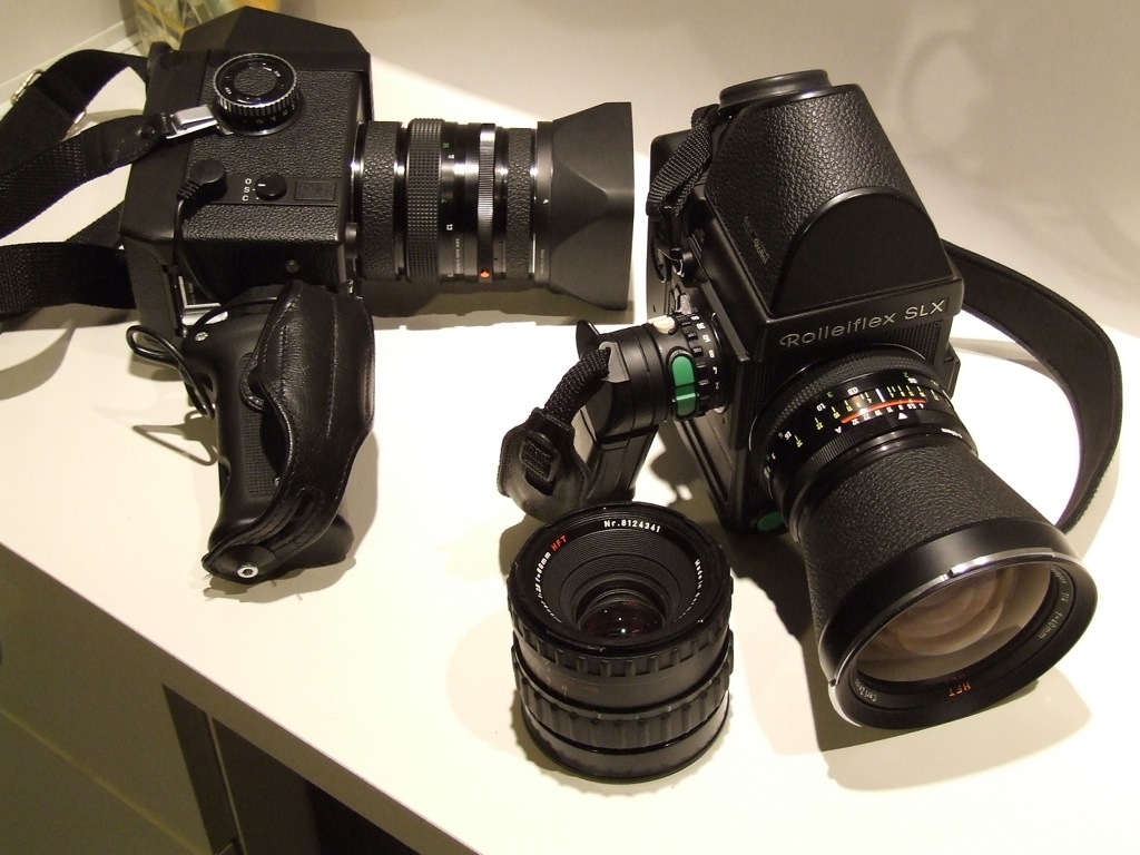

I have been using a 6000 series Rollie since the early 1980s. I recently upgraded to a 6008i (shown in the picture with the "SLX" prism). Great cameras. The differences between the models are small. Plenty of lenses out there. The 90 prism works well with the handgrip that fits below the camera. The 45 prism works best with the side handgrip.
