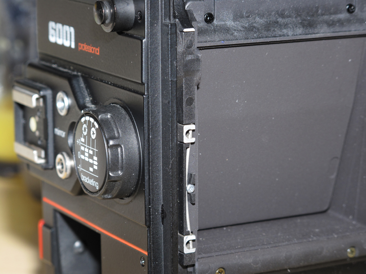

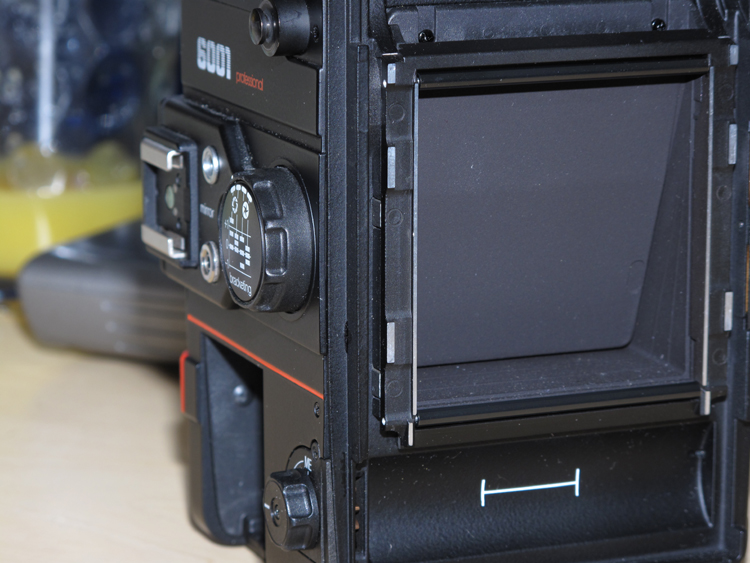

Please Check for A Missing Film Gate
Attached are two pictures that may help. I've seen a 6001with the screwed in place film gate, and 6001s with the newer removable film gate for Rollei Magazine 6450. If your camera looks like the picture without the film gate, there is the problem. On a related note, I've always found Herr Freudenberg at F&H/Rollei to be very helpful.

noumin
Tim, your great !
On my camera the filmgate is indeed missing, I'm relieved as now I know at least which one's the guilty part. There's a dealer warranty on the camera so I will have a word with them first.
