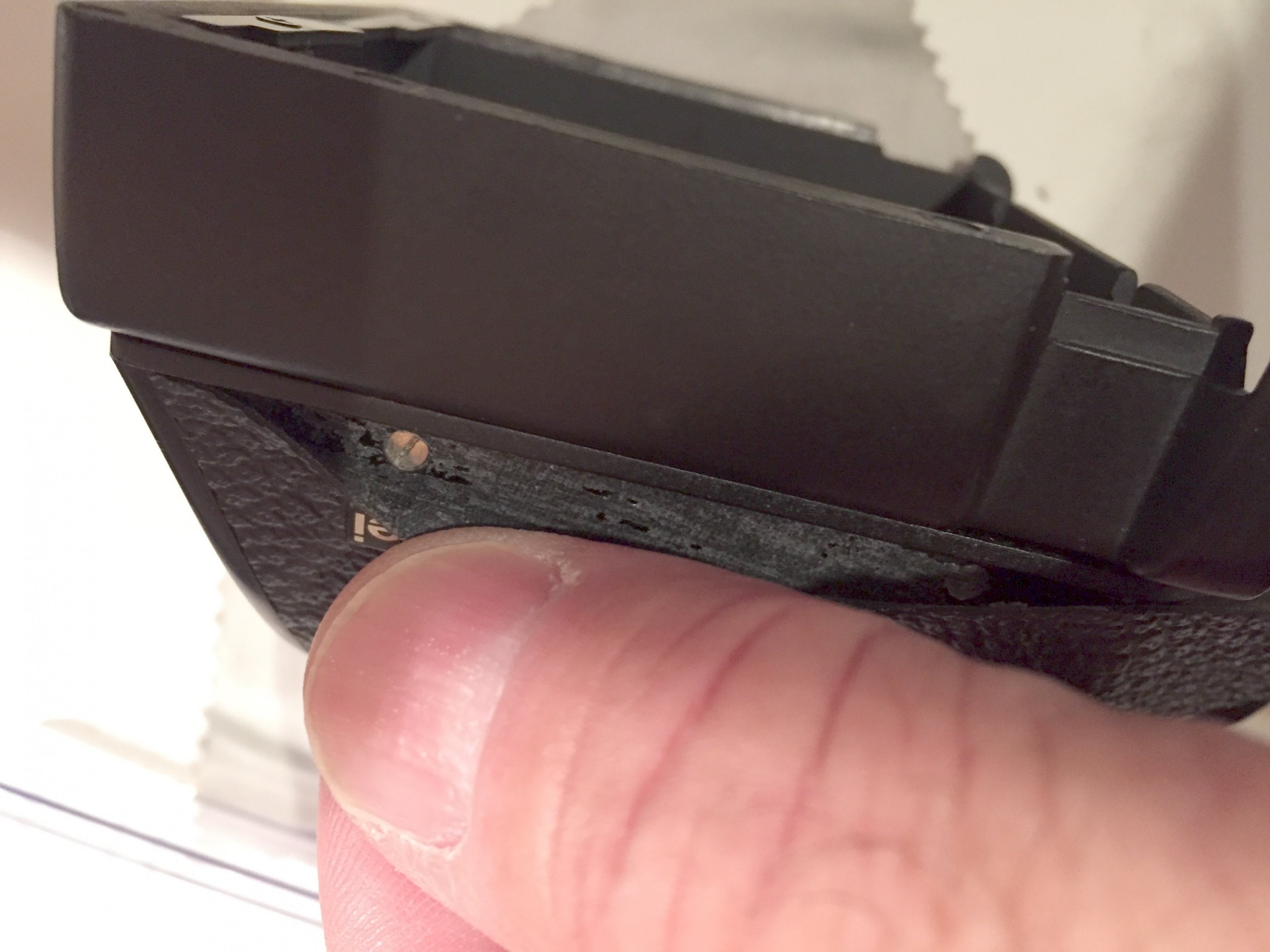

Under the covering are 5 screws to take to top off.

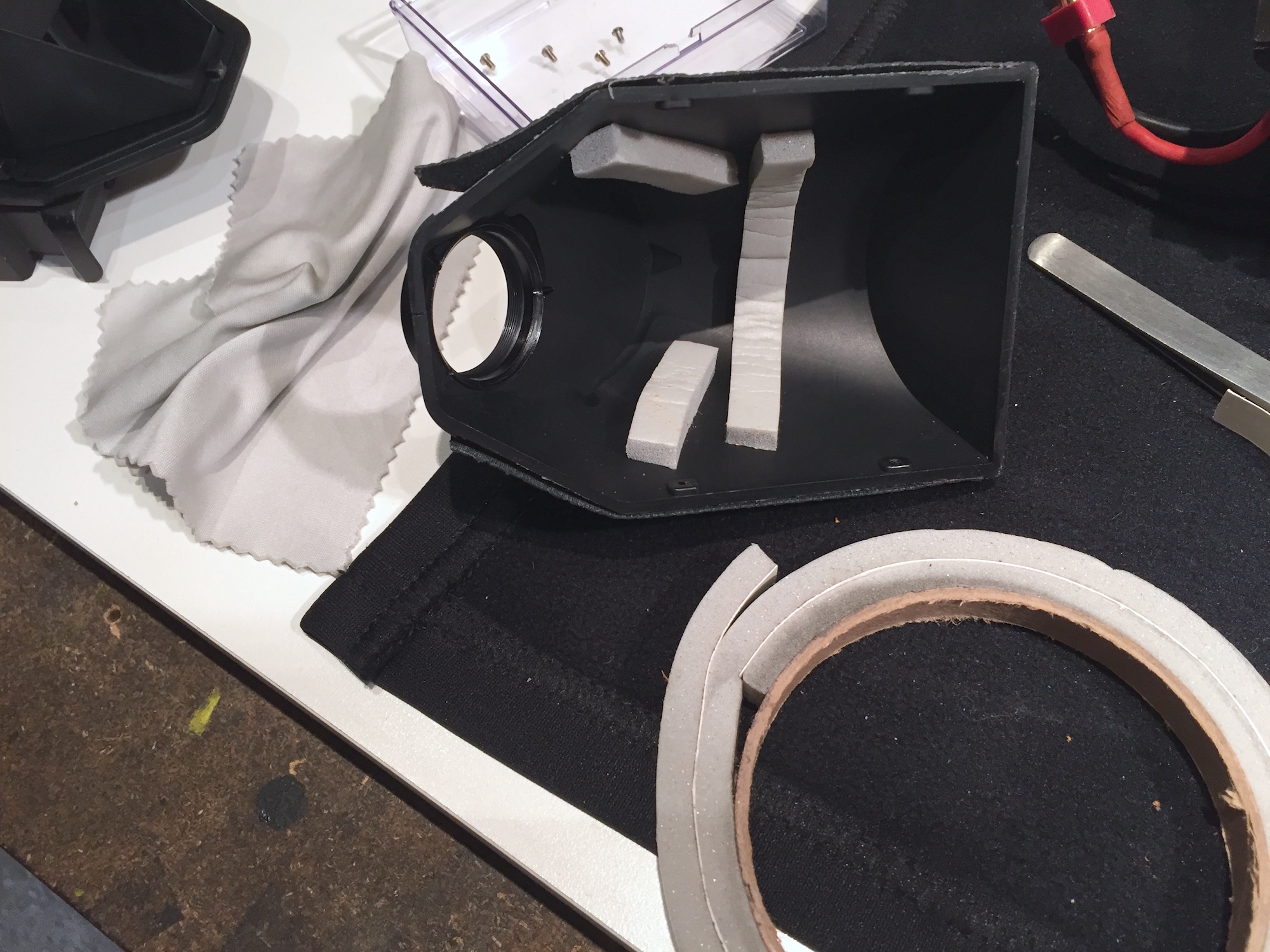

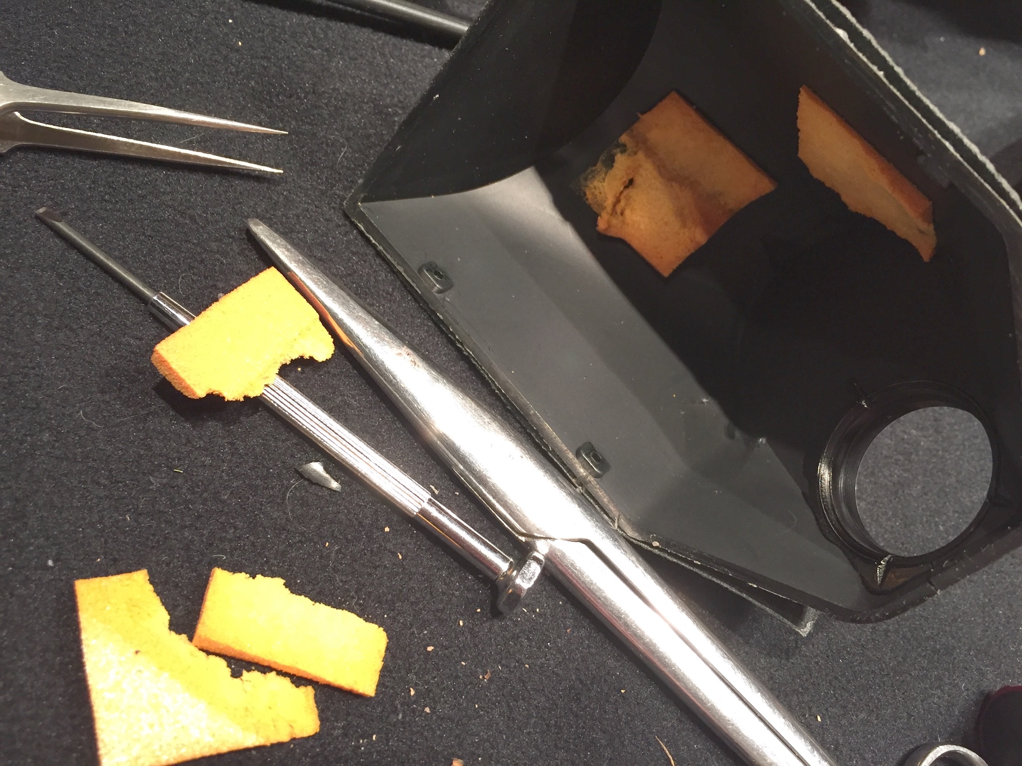

With the top off, one can see there is nothing in there except the prism. No other optical elements are anything else. The prism sits freely on the base, only held in place by foam rubber.
As you can see the orange foam has deteriorated.

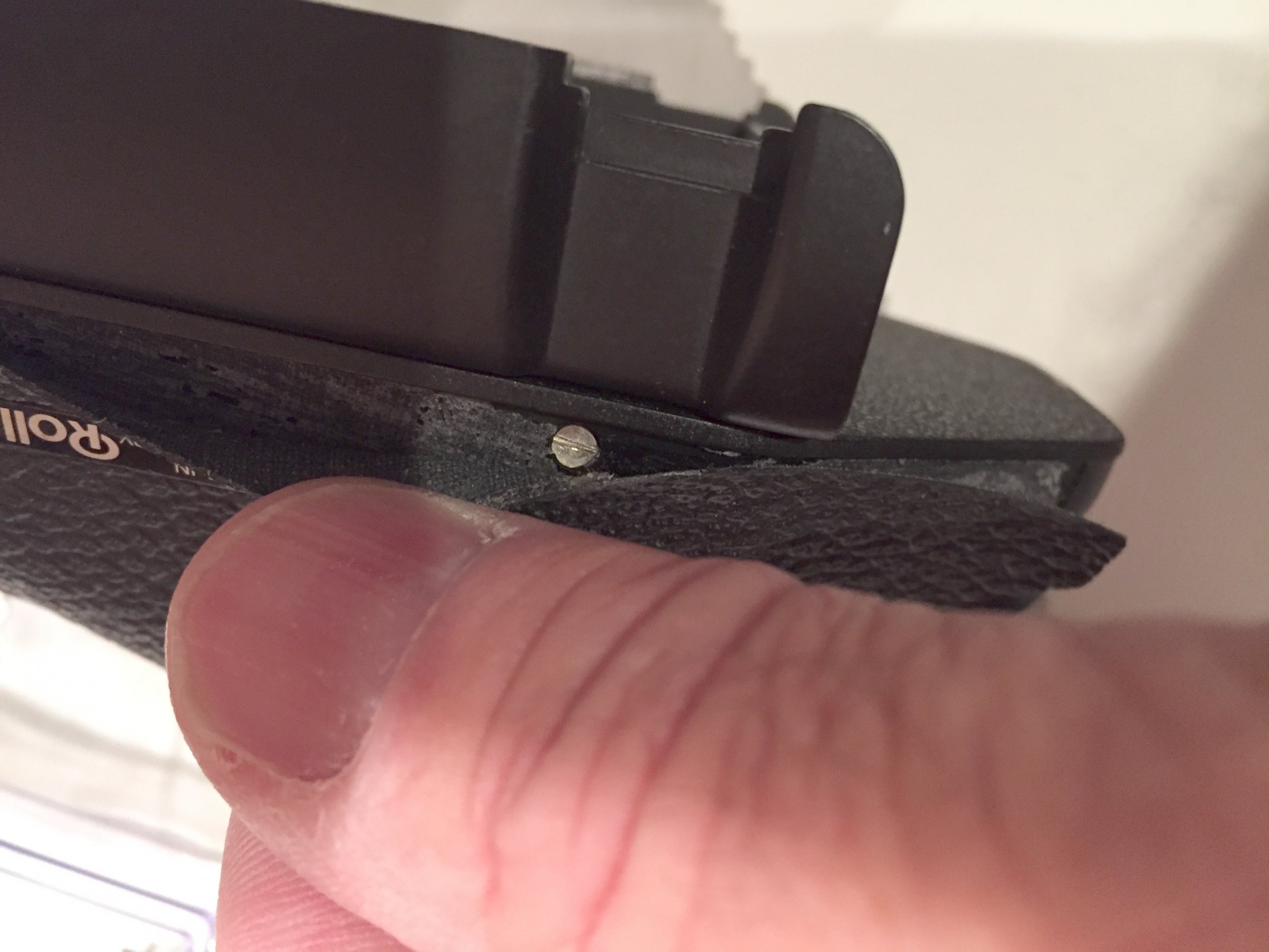

I cleaned the prism surfaces and fitted new foam to the top and re-attached it with the 5 screws. The covering was re-affixed with contact cement.

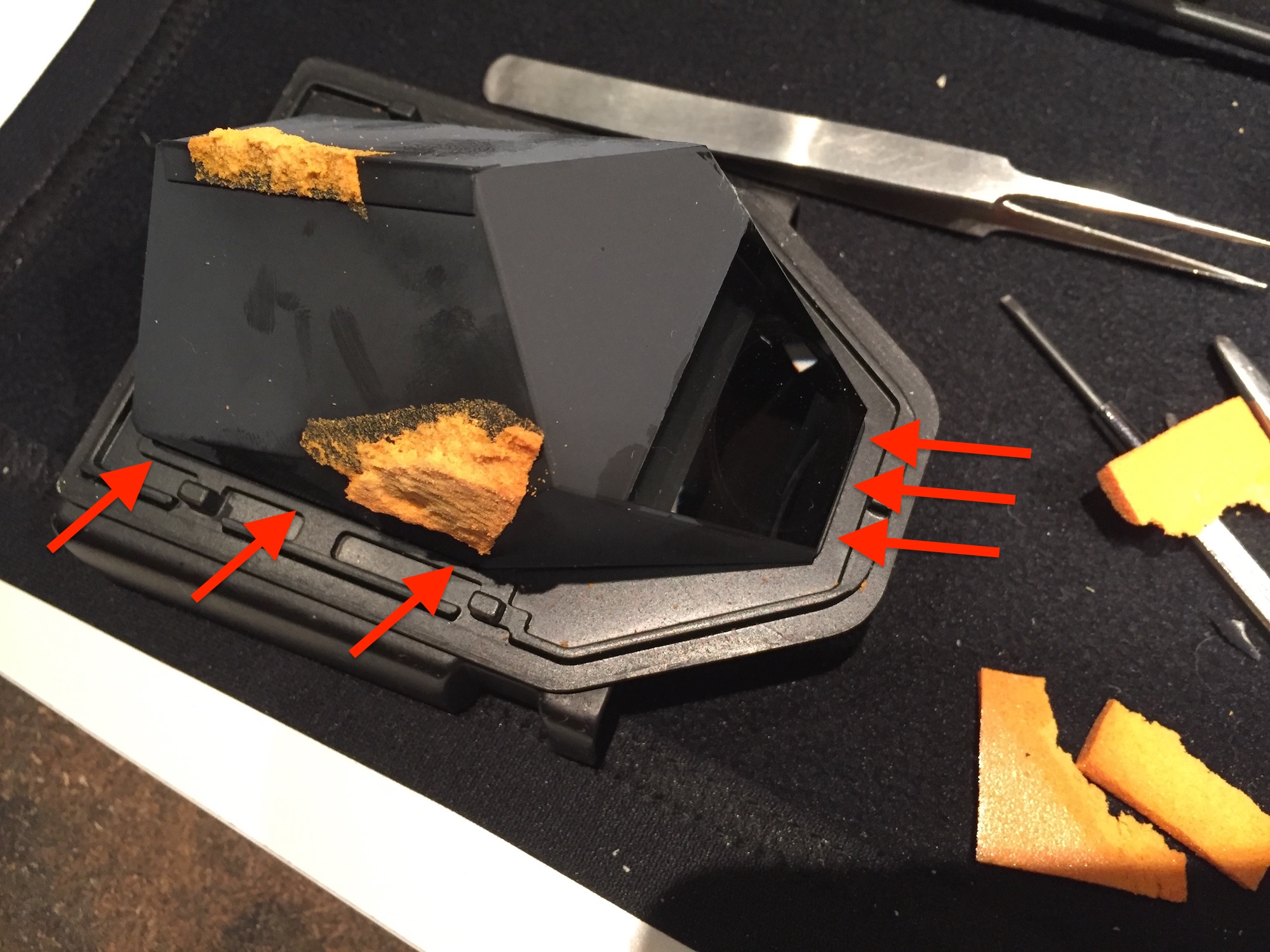

Yes, the prism fits in a specific location, outlined by a 2mm ridge of metal on the base plate. This ridge (indicated by the arrows) is obscured in the picture, because the bottom of the prism tapers inward. It is not a tight fit, so if the foam deteriorates, the prism shifts about one millimeter right, left and front to back. This causes a knocking sound as the prism moves around.
