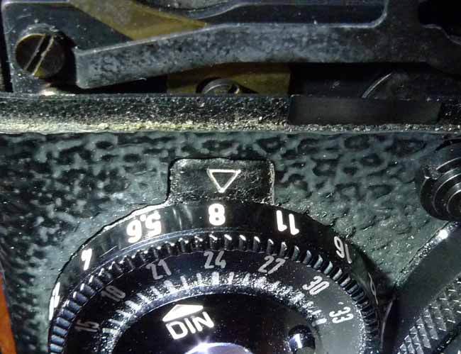

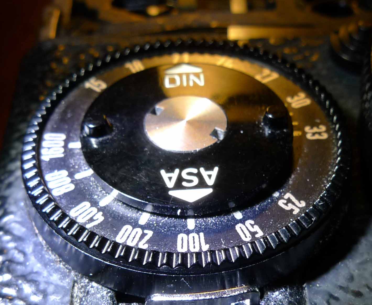

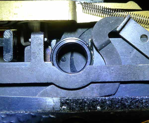

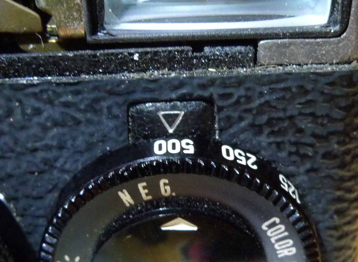

Thinking about this, decided to take mine apart…again
Hi,
I got thinking about this and realize it would be nice to have a safe place to start. So, I took my camera apart and took these photos. I set the camera at 1/500 of a second. I set ASA (not ISO) at 100. I moved f-stop until the little dot on the ND filter was in the middle of the window. I then noticed that the f-stop was at f8. This should give you a place to start.
Wayne
