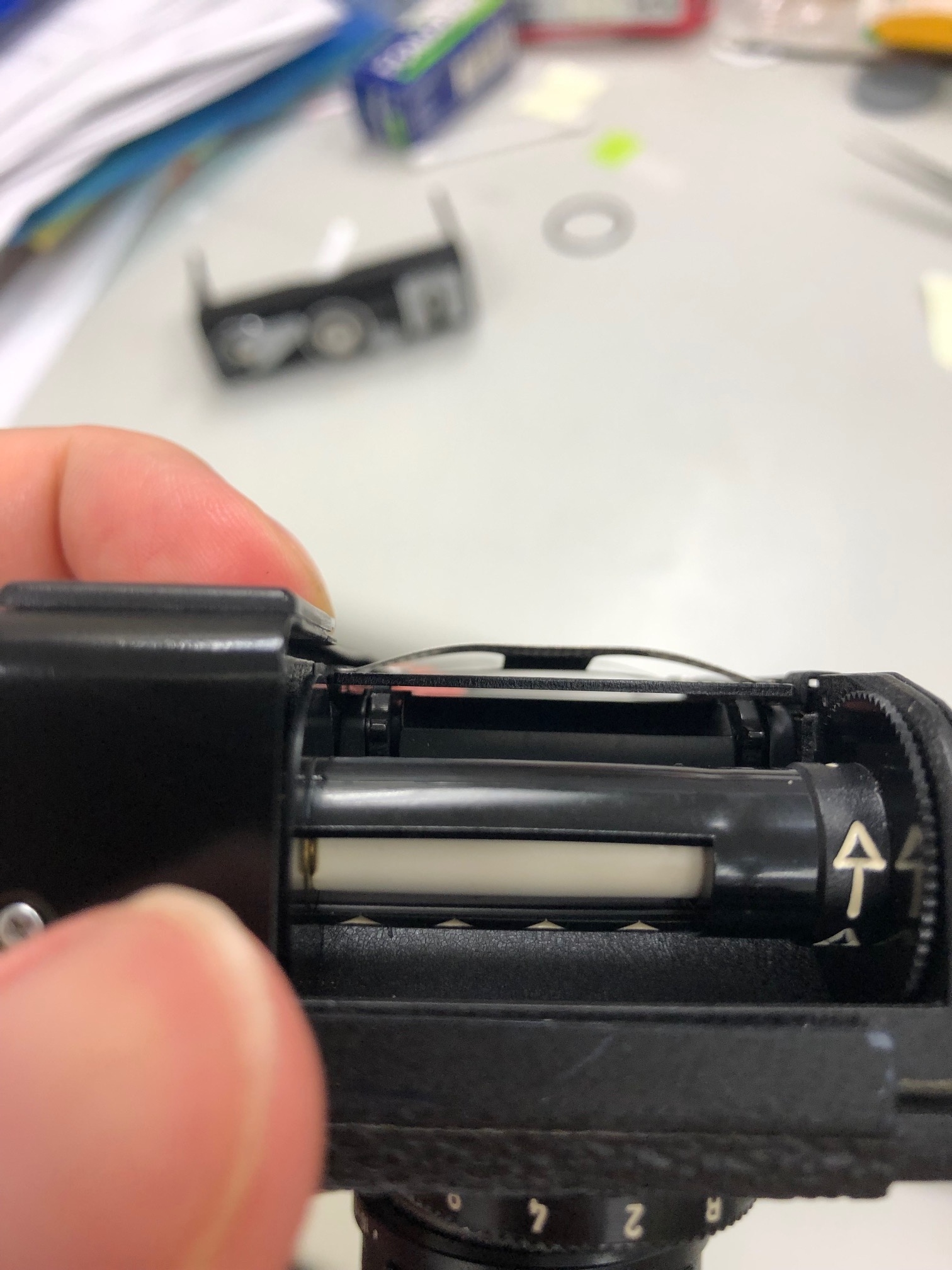

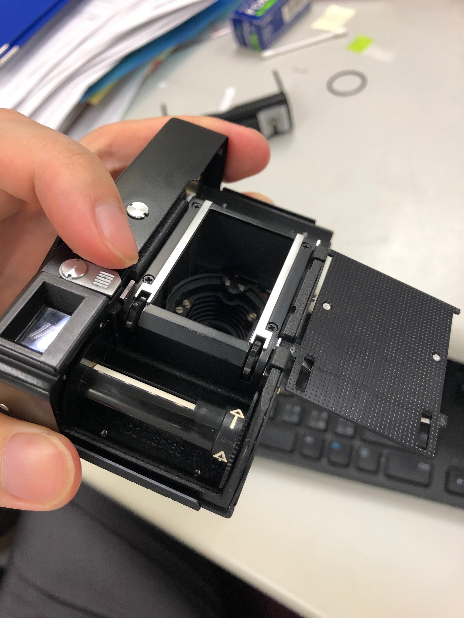

I recently acquired a Rollei 35 T. I first just want to add some grease to make the lens smoother when focusing. I also marked the relative position to ensure everything will be back to the original position. And by curiosity I use a binocular to try to test in the infinity focus is roughly correct by sticking a piece of paper on the film back and look through the lens with the binocular set at infinity. I observed that the infinity position seems off quite a bit and would just like to calibrate it by using a ground glass. But when I closely examine the film plate I discover that there is quite a bit of gap between the film rail and the pressure plate. This make me wonder if in actual usage the film will just being pull towards the film rail or just sit on the film plate. The gap is not small and is much thicker than the film thickness and so I guess it will definitely have an impact on the focus adjustment.
Does any one know whether the film position in actual usage of the camera?
Why the film pressure plate is designed to leave a gap and not just press all the way towards the film rail?

The edges/sprocket holes of the film rides on the chrome rails. The back of the film is held flat by the pressure plate. The film's emulsion imaging area doesn't touch anything. Often cameras have another set of rails that hold the film side-to-side.
Try putting a ground glass on the chrome rails and examining it with a 10x or 20x magnifier with the lens focused at infininity. The results should be about the same with the camera's focus set to 1 meter and the distance from the subject to the film plane at 1 meter (an alternate method for when it is raining outside).

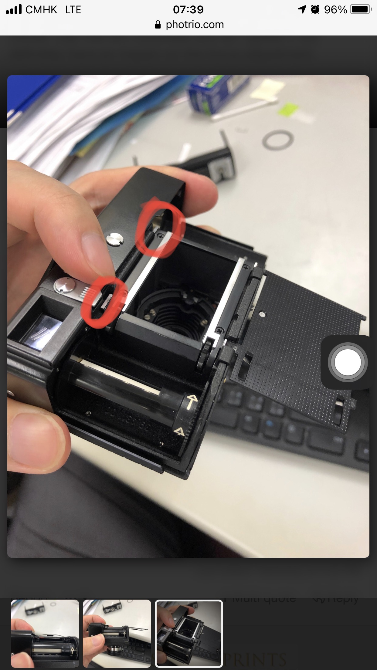

I searched the servicing manual and discovered that the film plate clearance is 0.22mm, which must thicker than film thickness. (i.e. The pressure plate is topped by the two outer rail, circled in red in the photo, to make the plate 0.22mm after the upper and lower film rail.)
Therefore I am doubting what focal plane (film rail or film pressure plate) should be used to test the focus.

Of course you had to open the lens to replace the grease and make the focus action smooth. I had the same issue with mine, so thought I might be able to help with the subsequent infinity issue. However, the interior design of the 35T is evidently quite a bit different from my early Singapore-made 35. At least your pressure plate doesn’t appear to be bent at the hinges, which is quite a common problem caused by previous owners.
Surely the film must lie flat from rail to rail with its backing flat against the pressure plate? The gap you indicate (if I understand you correctly) seems irrelevant. So your ground glass (I used plain glass with Scotch tape on the image side) should also lie across the rails, with the frosted side towards the lens. The moon makes a conveniently bright test image, in fact the only image I found I could work with. You also need to grow another hand to do this job.

The issue is the for rollei 35 T there is around 0.22mm space between the film pressure plate and the film rail, as noted in the servicing manual.
