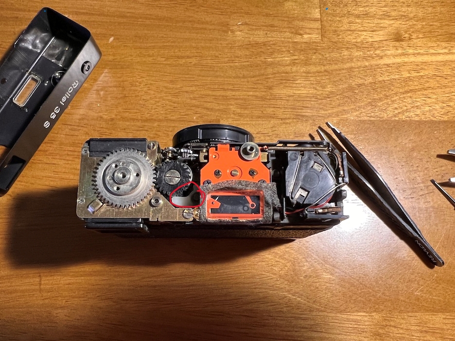

Hey again!
Great job getting it open!! Yeah exactly, both the white gear and the black parts that sit on top of it / under the spring are misaligned. You can realign everything by taking the top black gear with the screw in it off (by unscrewing it, of course). However once you realign everything you'll have to re-tension the spring by turning the top black gear one or two full rotations and then screwing it back in with the tension held and the silver winding gear in the correct place to hold the tension. Might take a few attempts to get it all set correctly.
One other thing you can try is to hold the lever circled in red in the image attached (the locking arm) past the rest of the gears with like a paperclip while cranking the winding gear to try to get the rest of the mechanism to reset, but not sure if that will work or not!
Might take a little fiddling to get it working but you're like 80% there!

e2d2
Mar 30, 2022
9
Washington, DC
gah!! i do feel like i've almost got it, but not quite. :sad: i am starting to think it's a problem with the locking arm? i can't figure out how to get it to lock (lol)

No worries at all, I'm happy to help as much as I can! It doesn't look like the white gear at the very bottom is turning when you wind the camera, which I believe is supposed to happen. I think that gear is what primes that white lever to lock into the black pieces of plastic under the spring, preventing it from continuing to wind. If you're confident going one step further I'd try to unscrew the black part that holds the screw and pull everything on that shaft out, to see what's going on in there. You can re-seat everything so that it all turns correctly and you should be able to do a full wind. Either that or you can keep trying to move things bit by bit as you crank to hopefully knock it in place!

But yeah I think you're almost there! Iirc (take a look at your previous videos as well to confirm), the two "dots" on the top black gear with the screw (those like weird little bumps) need to be perpendicular to the silver metal winding gear - basically I think that black gear might just be a few notches off to where it's supposed to be. Try lifting the metal winding gear up and moving the black gear one notch at a time and then try cranking to see if it works as it should. Just remember not to let the black gear lose it's tension when you're lifting up the metal one!
Next step if the above doesn't work is to go just a touch deeper and remove the housing of the metal winding gear. There's one more gear in that shaft that might be out of place, which was the case with mine the second time it broke. You can see the 4-5 screws that hold that brass bracket over the winding shaft - if you were to remove those you can get access to that mechanism. From there you can basically make sure everything is at it's "starting" position.
Good news is I was in basically in the same exact situation you're in now and I was able to fix it, so you can definitely do it! Getting major PTSD from watching all these videos though lol.
Keep me posted!
