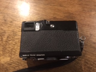

7919913D-0887-4602-B4D2-F98AF96F16EA.jpeg 8972DF9A-6D56-4514-A37C-83B72A38A5DA.jpeg Hello,
I was wondering if someone knowledgeable about Rollei 35’s might be able to help figure out what camera I have. It is a black Rollei 35 S but the lens is a Schneider Kreuznach S-Xenar 3.5/40. Made in Singapore. I can’t see a serial number anywhere.
I was under the impression that the “S” stood for Sonnar, which are the 2.8/40 lenses. Anyone know what’s up with this camera? Did someone maybe give it a paint job over the serial number or did some surgery to replace the lens? That’s the best explanation I can come up with. Any help would be appreciated!

What I recall is that the S stood for "Silicon" -- as in a silicon blue photocell in the meter -- and that the 35S, like earlier models, was sold with more than one lens choice.

Interesting, I thought S just stood for Sonnar, but maybe I’m wrong. Thanks for your reply.

Rollei 35 S (and only the 35 S) had the Sonnar 40/2.8 lens. I'm with the other opinions on a top cover swap. The top covers dent very easily without actually damaging the workings. Someone had a non-working 35 S and swapped the top cover with a dented up 35 (or 35 T identical).
