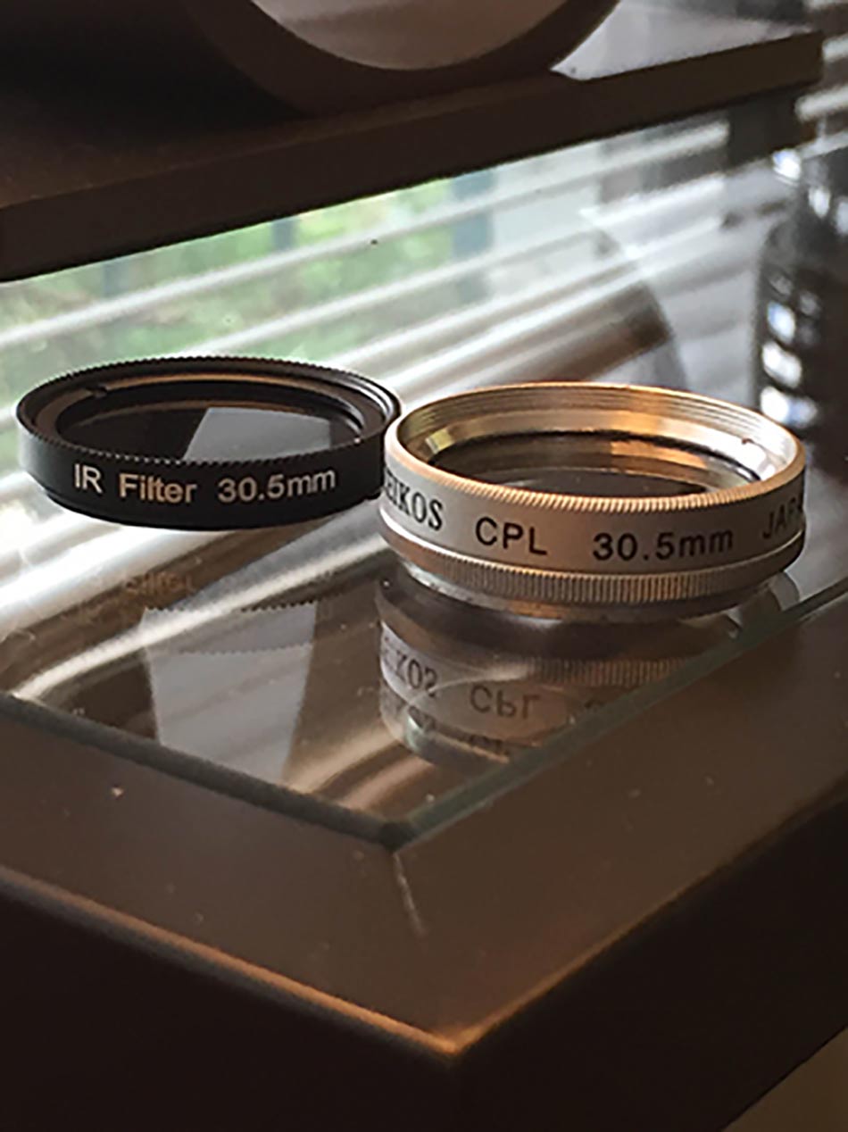

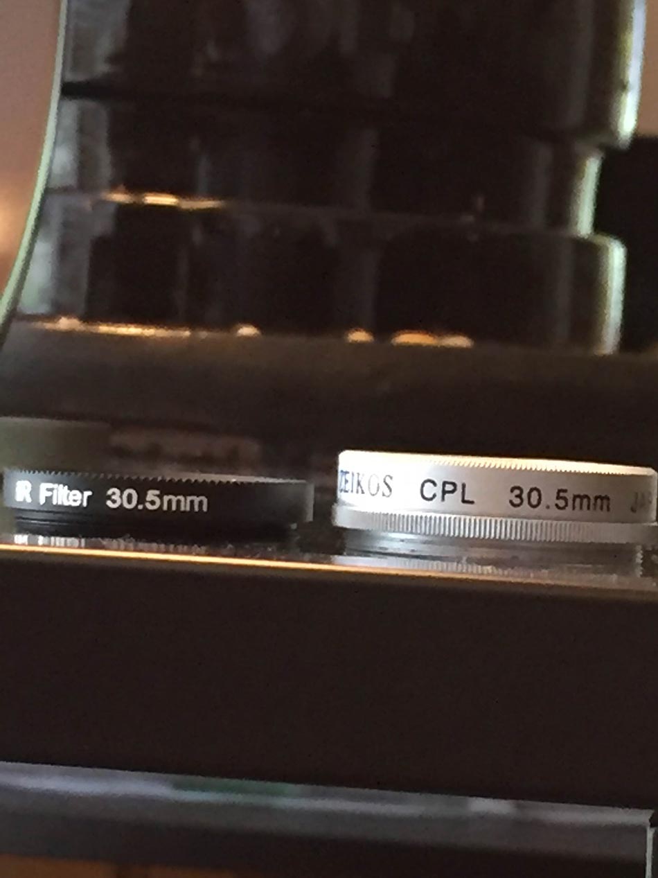

Hi All! Just bought a Rollei 35 s and want to use it for infrared film photos, since it is
not TTL and I can actually see what I am framing. I am told that a polarizer in addition to the r72 filter is the best way to shoot infrared to get the deepest IR effects. I am wondering how many 30.5mm filters you can stack on the Rollei 35 s before it starts to vignette your image.
I know different filters are different thicknesses, but just as a ballpark, is only one filter all I can use on that little 40mm lens before the filters start to creep into my frame? Or can i get way with stacking two filters?
The filters I intend to use are Zeikos CPL 30.5mm and some no-name 30.5mm 720nm IR filter.
As you can see from the photos, the CPL filter is almost double the thickness of the IR filter.
So I just want to see if anyone has had experience with stacking filters on the Rollei 35 S? I dont want to have to blow a roll of film to find out if it will vignette or not.

Actually there is a way you can kind of see in advance. You need to put the filters on and then, with no film in, take the back off the camera and open the fstop all the way and hold the shutter open in B. Now put your eye right up to the back of the lens and look from one edge of the film gate to the other edge of the front of the lens. If you see can the edge of the filter it will vignette. If not, it should be ok. Back when I used to do commercial photography with a view camera, I would tape the lens shade off right to the edge of the image in order to eliminate any chance of flare. I could look through the cut corners on the ground glass through the lens and see exactly where to put the tape.
Same sort of principle.
