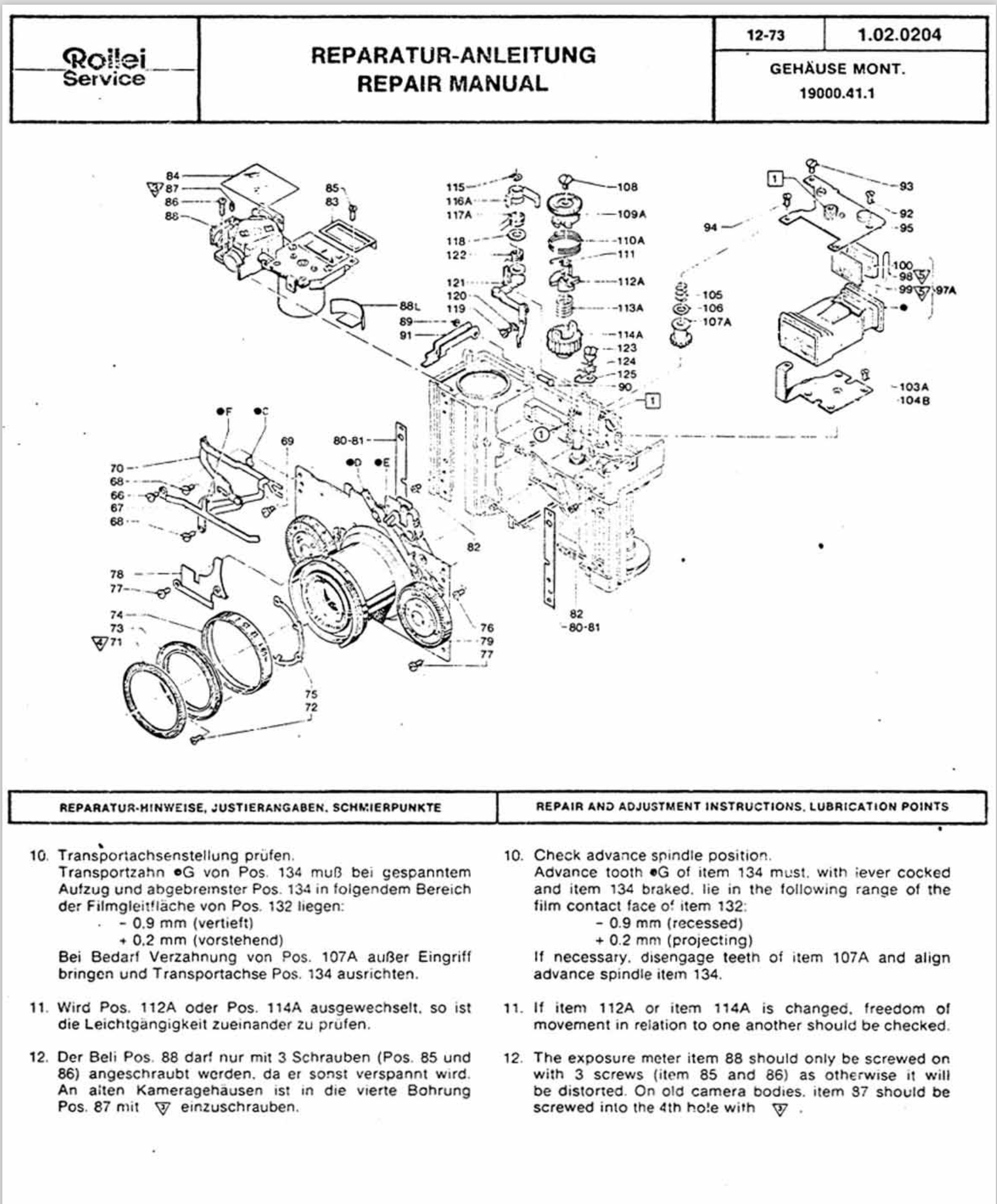

Do you have the service manual? Which version?
I recently refurbished my 35LED, with a new top I found on ebay, but my advance was working ok though.

I don't. Is it on the Butkus site? The linkages for the shutter and aperture controls (and their connection to the meter match-needle) are simple enough I first fixed them when I was 14, and the advance parts may be as well, but I've never gotten into those parts on one of these.

Not sure if this helps, but if you PM me, I can send the whole PDF.
