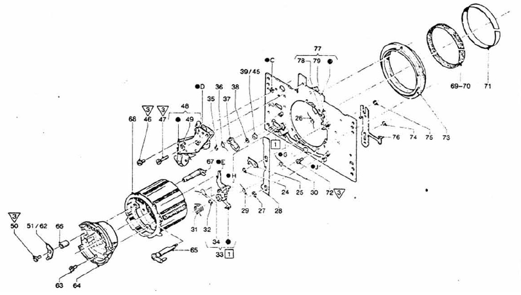

I am trying to restore a Rollei 35 camera with Tessar lens. I managed to repair the light meter and the stuck shutter, but after the second roll of test film the blade pinion broke due to material fatigue.
According to the service manual, it is the part number 67:
I have been unable to find this part for sale and I feel it's not worth buying a broken camera for such a small issue.
Does anyone know a seller who can have this part in stock?

I have the remains of a 35B - in one piece except for top cover bits. The lens etc is intact. IF it's the same part on the 35B and IF you want to cover the postage to Spain (I'd have to find out what it is) I could send it to you for just the cost of the postage. PM me if interested.

I have checked the manuals and it is the very same piece.
I'll PM you inmediately!
