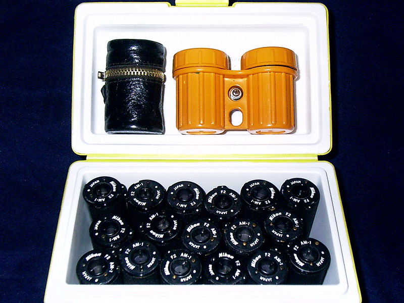

Any recommendations for where to acquire good quality film canisters would be great appreciated.
You can find Nikon AM-1 film cassettes on eBay and if you do not have an F2, you can find them on eBay also.
I would take one-hundred feet of 35mm film and roll my own. One-hundred feet would usually give me about 19 rolls of 36-exposure film.
Nikon AM-1 Film Cassettes
by Narsuitus, on Flickr

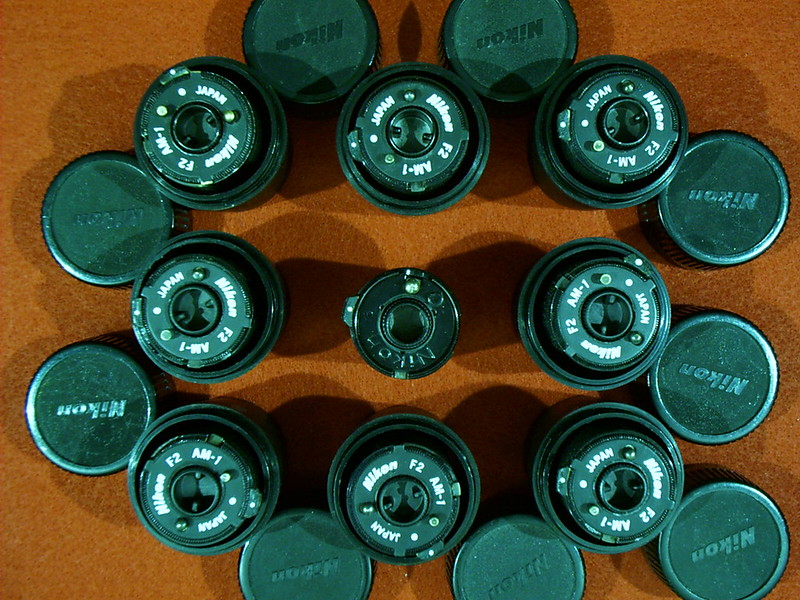

Back in the 1960s, I saw a Leica film cassette in a camera store selling for an astronomical price. Since I had the opportunity to buy Nikon film cassettes for Nikon F and F2 SLRs for a reasonable price, I started buying them. Glad I did because the Nikon cassettes are approaching astronomical prices.
At the time, in addition to the cost savings of rolling my own, the absence of felt light traps ...
1. Allowed the film to move faster and smoother as the motor drive pulled the film out of the cassette.
2. Were less likely to scratch the film (especially the thin emulsion films) as it was pulled out of the cassette.
3. Did not shed fuzz from the felt light traps strips that were found in less expensive and less durable film cassettes.
The reloadable Nikon F film cassette seen in the center of the image only works in the Nikon F.
The eight reloadable AM-1 film cassettes seen in the image only work in the Nikon F2.
Nikon also made a reloadable film cassette that worked only in its rangefinder cameras.
Nikon Film Cassettes by Narsuitus, on Flickr
