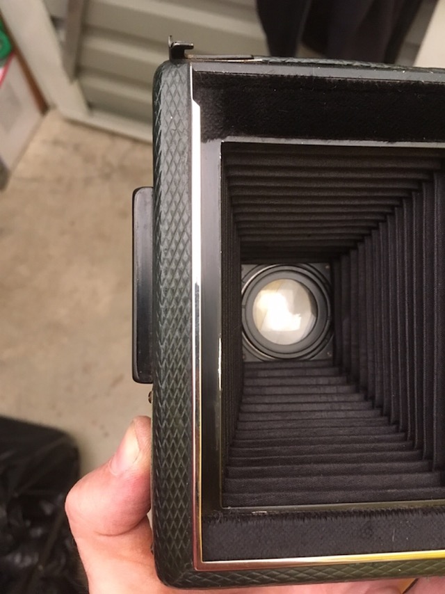

I am looking at a Voigtlander Avus which is made for 6.5x9 plates. Will any of the available roll film backs for 120 film fit the camera? The lens is a 105mm so it is correct for full frame 120.

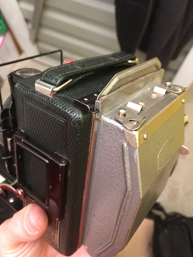

This is a "Zeiss Ikon" 6x9 back, it fits but the tab for closing the back/cut film holder doesn't close so it could happens when taking out the dark slide to take out the back as well, not good.

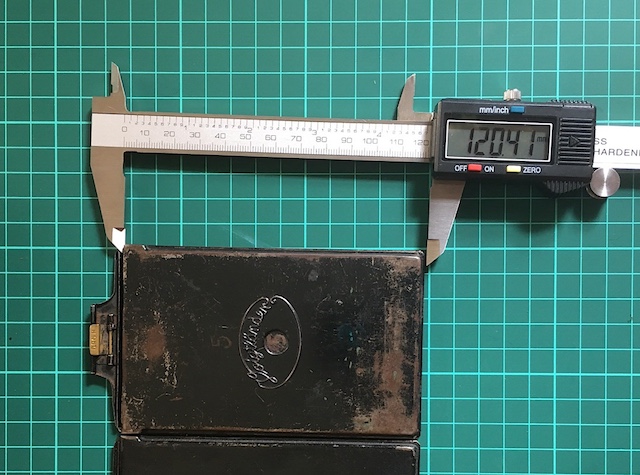

So the distance between the lower rail and the tab are exactly 12cm, checked with calliper.
Back at home, 6x9 Voigtlander cut film/glass holder, fits perfectly.

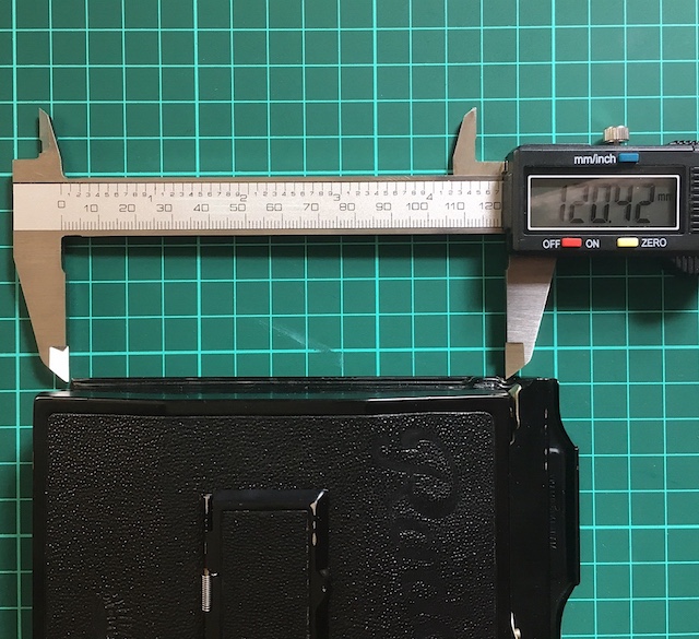

Rada film holder, from the bottom to the insert that the tab can lock the roll film holder, 12cm as well. Plaubel Makina II (from II and ahead I checked this) has this locking tab as well, probably copied from Voigtlander as "standard".

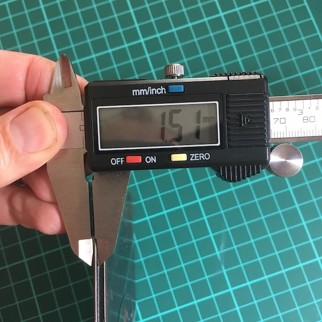

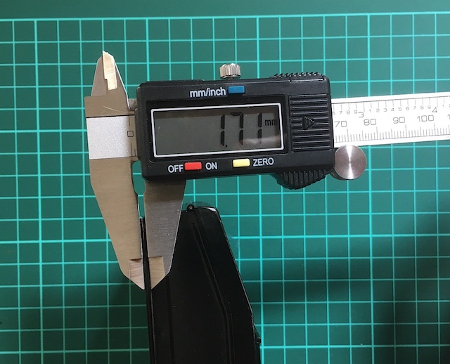

Thickness of Rada film holder, 1.7mm.
Thickness of Voigtlander 6x9 cut film/glass holder, 1.5mm even at some points is less.
Meaning the Rada probably will fit and don't move at all, at least the one I own. I hope I remember next time when I visit my friend to take the Rada with me to be sure.

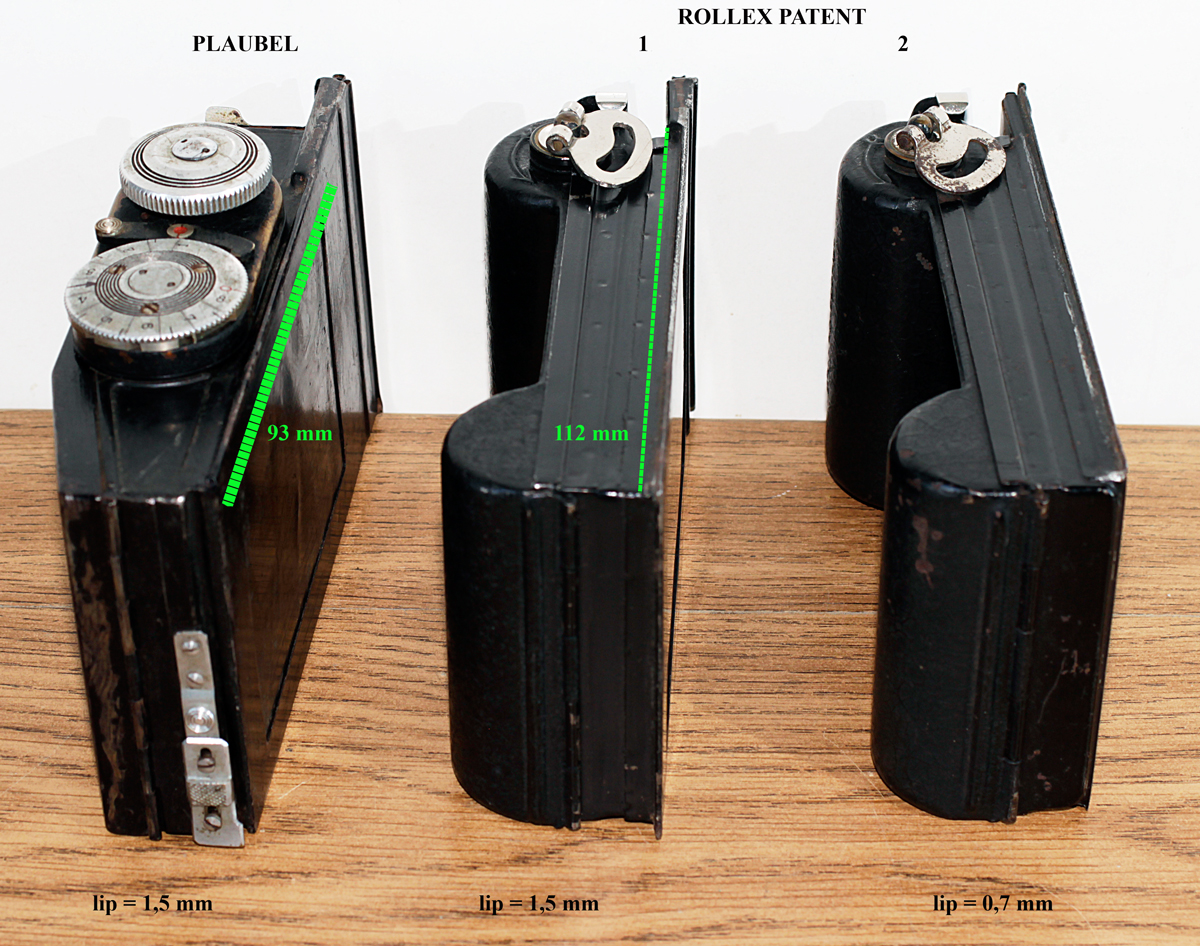

Here are 3 6X9 backs ; only the n°1 Rollex Patent fits the Avus camera.
The lip of the "true" Plaubel back is not long enough ; the one of the n°2 Rollex is too thin (but
it fits the Patent Etui).

Yes, the Plaubel is designed for Makina cameras, the lock is done from the bottom tab of the holder.
