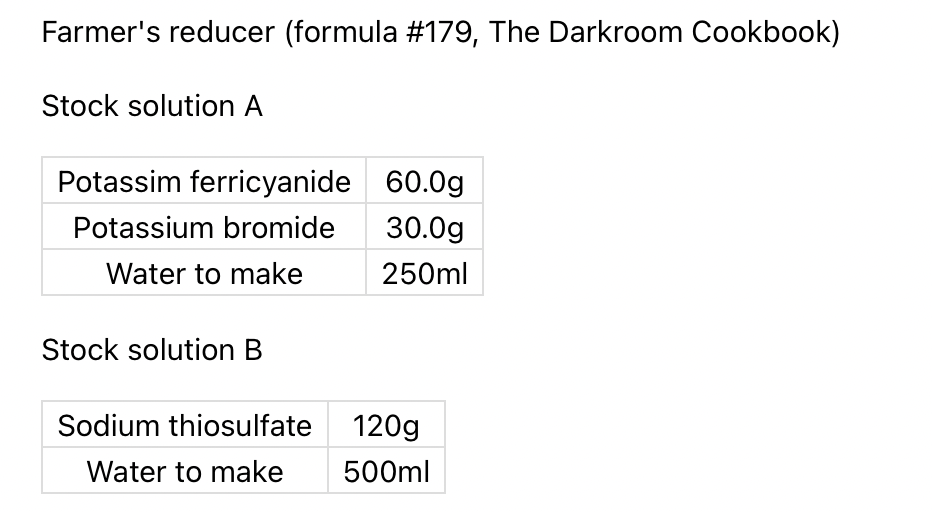

Found many answers to my questions regarding bleach in various Phototrio threads, except those regarding sodium thiosulfate.
I do understand the role of the potassium ferricyanide, of course, and also understand that the addition of potassium bromide makes the bleach a rehalogenating bleach, meaning I can re-develop the print.
What I'm not sure I understand is the role played by sodium thiosulfate in Farmer's reducer. What, exactly is its impact? Can I still re-develop if my solution contains both potassium bromide and sodium thiosulfate, or is that cancelled because of the sodium thiosulfate? Do I still need to fix the print afterwards?
I use this formula from the latest edition of The Darkroom Cookbook:
revdoc
Apr 12, 2015
315
Sodium thiosulfate is fixer.
The reducer does this:
Ferricyanide and potassium bromide convert silver to insoluble silver bromide.
Sodium thiosulfate forms complexes with silver bromide and effectively dissolves it, removing it from the emulsion.
The second step is just what fixer does with film and paper normally, and makes this process irreversible.
You shouldn't have to fix after reducing, but I guess a lot of people will, anyway.
The thiosulfate does two things: (1) it accelerates the bleaching action and (2) it renders it irreversible. The thiosulfate acts as a fixer just like in a regular B&W process. What's fixed out, cannot be redeveloped later. Hence, no fixing is needed after Farmer's reducer, no redevelopment is possible, but the print of course should be washed at the end of the process.

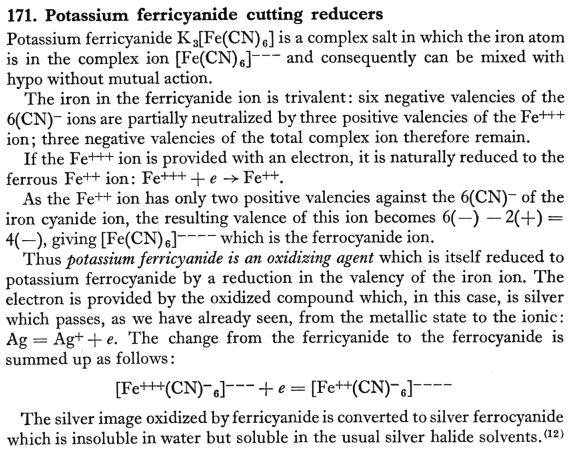

"Photographic reduction is a chemical oxidation process, a somewhat confusing situation, because chemical reduction is not the principal reaction when the term "reduction" is used. Reduction refers to the lessening of the amount of metallic silver in the image, not the chemical reaction involved in the solubilization of the image silver."
Grant Haist in Modern Photographic Processing Vol 2.
