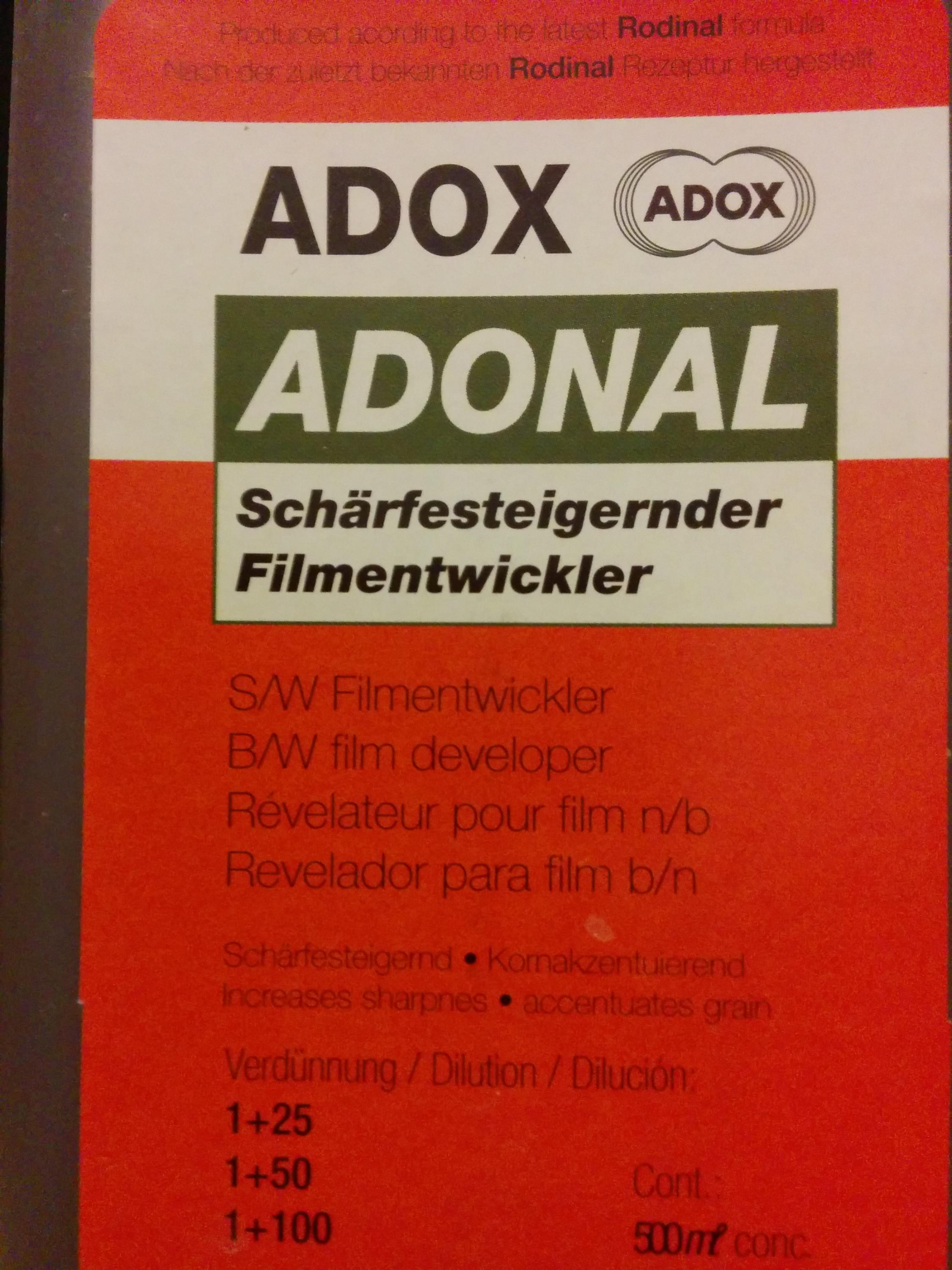

If 300ml is 50 parts then 1 part is 6ml, which is 1+50. What is so complex in getting the concentration right?
If 300ml is 25 parts then 1 part is 12ml, which is 1+25 and so on...
grommi
Mar 14, 2010
165
continental
No, it's 1:50 and 1:25 or 1+49 and 1+24. If you don't think it matters think about Xtol e.g., 1+2 = 1:3
Yes, it's not complex, it's very simple math.

Its 1+25, 1+50, 1+100,...for me.
