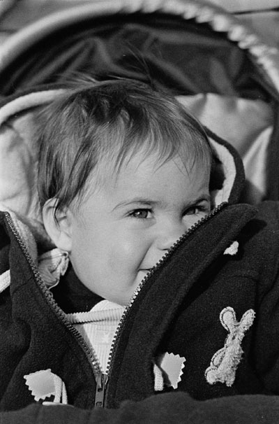

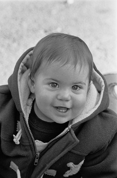

I have scanned the negatives. It looks like that the shots in the sun have a good separation of values, whilst the ones in the open shade or indoor look a bit muddy. Not sure whether it's a problem with the exposure or simply that you cannot have everything right (both in the high contrast and low contrast scenes). Or maybe I am just not good at scanning? :D
I have attached a couple of scans of both sun and shade shots where you can see the difference.
Hopefully I will have a chance to make some test prints during the weekend.
Stefano
df cardwell
Jul 16, 2005
3,358
KY USA
Look fine to me: one looks like it was in the sun, the other in the shade . You can simply add contrast to taste !
