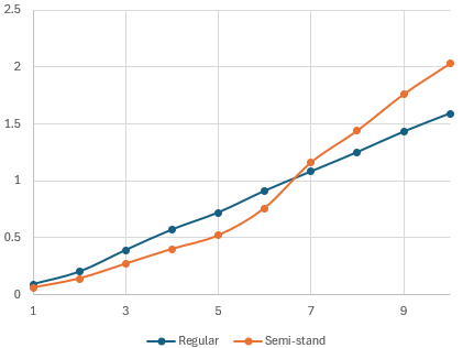

Thanks so much. Plotting both together gives this picture:
Which suggests something very odd was going on with that semi-stand experiment. It progresses quite linearly up to zone V, then goes very steep for 2 zones before it continues up linearly again, but at a higher gamma than initially. That's an odd kind of curve and quite different from what you usually get, even for semi-stand developed film. It's not the 'usual' upswept curve you sometimes get with certain developer/film combinations.
All curves I've got with stand / semi-stand development have had significantly sub-standard results and often certain oddities. Therefore I have made the decision for me to stop doing even more further tests. Also a big disadvantage for me is that so much more time is needed until I see my final developed results. That disadvantage is also in addition to the other disadvantages I described in my first post.

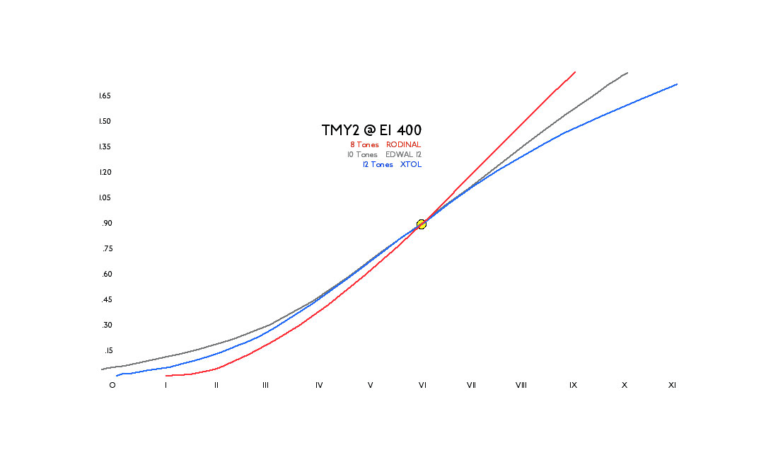

Initially it was conceived to tame the contrast and with that in my mind I stand developed a Pan F+ for an hour and that ended with a bromide drag near perforations.
But I would recommend Rodinal for semi-stand development like 3 inversions every 5 minutes and this semi-stand scheme works for some of other developers too.
Unfortunately, the URL is missing but one picture will help you in understanding a bit about taming the tone curve.
Thanks to @df cardwell for the post and the picture.
You have to click on "Overview" to reach the original ressource.

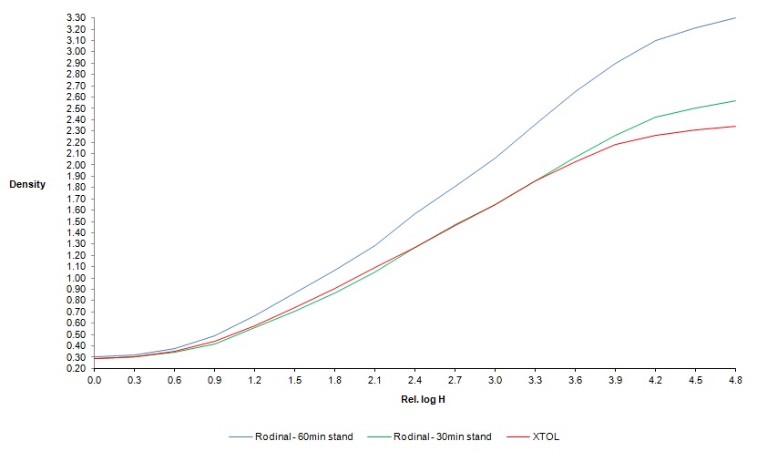

The short answer is - no, it's not a good idea for two main reasons without getting into the weeds:
1. Uneven development is a certainty. This may or may not matter depending on how busy the pictures are but beware.
2. Difficult to control. Despite claims that it is a kind of automatic, self-limiting thing, in fact the amount of development you'll get over these long processing times can vary greatly unless you are very careful about things like temperature.
The question I always ask is "why?". What is the goal? If it's about image structure (perhaps an attempt at maximizing edge effects), fair enough - if it can be shown to be more effective than other methods. If, on the other hand, it's supposed to be an automatic-compensating process, I can only say in controlled testing I did not find this method to yield any kind of miraculous sensitometry/tone reproduction results (see graph below comparing the resulting curves with a baseline process), in which case I'd say it's basically all risk, little/no reward - though I should point out different films may reacts differently.
Always keep in mind in photography when it comes to this sort of thing people often see what they want to see and assume X is happening when in fact that might not be the case.
It's also perhaps worth mentioning when I did controlled tests of this, I found the "standard" 1-hour time for the usual 1+100(99) dilution to be way too long if the goal is a normal gradient. 30 minutes was more appropriate (see graph again).

I can't really explain the odd curve shape you got and would have expected something as shown above in #22.
Maybe it has the following reason: The last time I did these tests it was in the summer. The developer had 20°C, but the room temperature was higher, in the 22-23°C range. The increase in the steepness of the curve started when when I did the turn / agitation in the middle of the processing. This together with the warming up of the tank and developer could have caused the steepness increase.
Nevertheless, I don't care much anymore. In all my tests the results have been significantly inferior to standard development. Not a single advantage could be found, only severe disadvantages.
If someone wants to tame a high object contrast, just use Rodinal in 1+75 or 1+100 dilution with standard Agfa agitation, or with 1 turn every minute.
Works very well and much much better than stand development.
