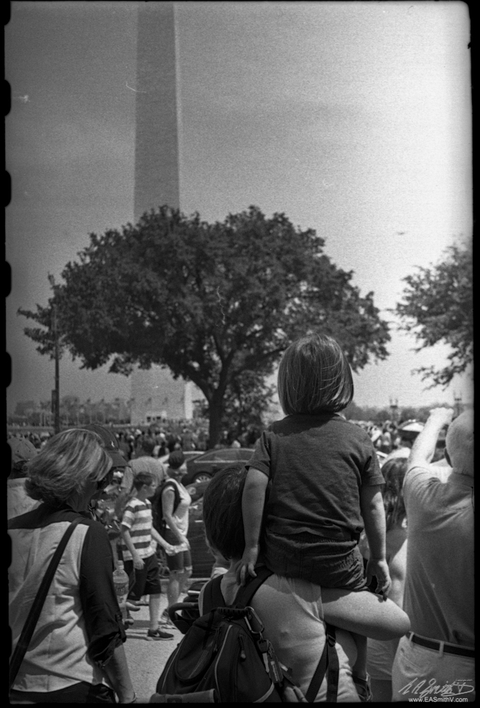

Hey folks,
I stand dev rodinal all the time and sometimes get this in skies or areas of a lot of white,
but it's never really been too much of an issue. But on this shot it was pretty extreme, and I'm wondering what's causing this and how to correct it? Acutance seems extra high in this shot too.
Dev was super dark rodinal (adonal) 1:100 1 hour with an inversion 30 minutes in, film was tri-x at box speed

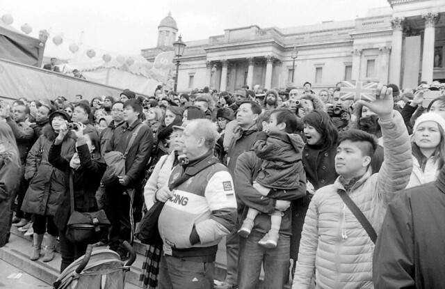

Hi
How is the negative?
What camera? What film?
A bit more info, please.
And a photo of the negative strip would help.

It appears to be bromide drag. I get this when I use stand development of high speed films (400ISO and up) in Ro9 with full hour stand, no agitation beyond the initial 30 seconds.
I'm told that when you do a bit more agitation, like 2 inversions every 15 minutes, it would reduce the effect considerably.
Rollei RPX 400 in Ro9 'One-shot' 1+100, full stand
Dead Link Removed

I do stand and semi stand in Rodinal. But I see too often that people have problems with it, so I don't recommend this technique to new comers.
One of the problems could be too small amount of liquid in the tank, and on the top you have foam on the negative, not liquid. And this foam will develop negative area but not complete as liquid. If you need 500 ml of developer - then put in tank 650-700 ml, to be on the safe side. With dilution 1+100 it is not a cost problem.

Stand development requires that the surface of the developer solution is well above the top of the reel. Next time use more.

I use stand 1:100 Rodinal 60 mins, in multi tanks cause I never have the correct number of films so I process several different film types at the same time.
I always add liquid to just cover the top reel, cause I invert several times at beginning to remove air bubbles. And you need as much flow as you can get.
Never had a density graduation but was the rebate printing top and bottom different in density? If it was not different and the shutter runs vertically you could be seeing capping symptoms. But I'd not have expected them to be as uniform as that...

Film is tri-x shot in a barnack leica, in a Patterson tank with the solution mixed to a full liter (10ml + 1L), so there should be plenty of chemical and developer. Was given a full hour development time. I usually do a couple inversions but I haven't in the past but this result is a bit more dramatic.
Also, anyone notice tri-x anti halation dye seems darker than it used to be?

I'd only use 3mls in 310 mls for a single reel you need the surge if inverting to dislodge bubbles at the beginning.
Never seen uneven like that over nearly 60 years of full stand in paraaminophenol.
Never seen a minimum quantity of developer in instructions for Azol or Agfa Rodinal, so I treat that as web gossip.
The depth of the pink colour does seem to vary I get deepest shades in HCA, only light tints in developer I don't use acid fix.
Is the printing of the rebates top and bottom of film uniform in density?
The light image on positive means you have dark negative ie probably a light leak rather than a development issue.
You need to look at the negative or flat bed scan the 24x36 frame and the sprocket hole rebates.
If the sprocket area is also dark on the negative it is a leak into top or bottom of take up spool area probably...

And bromide streaks.
