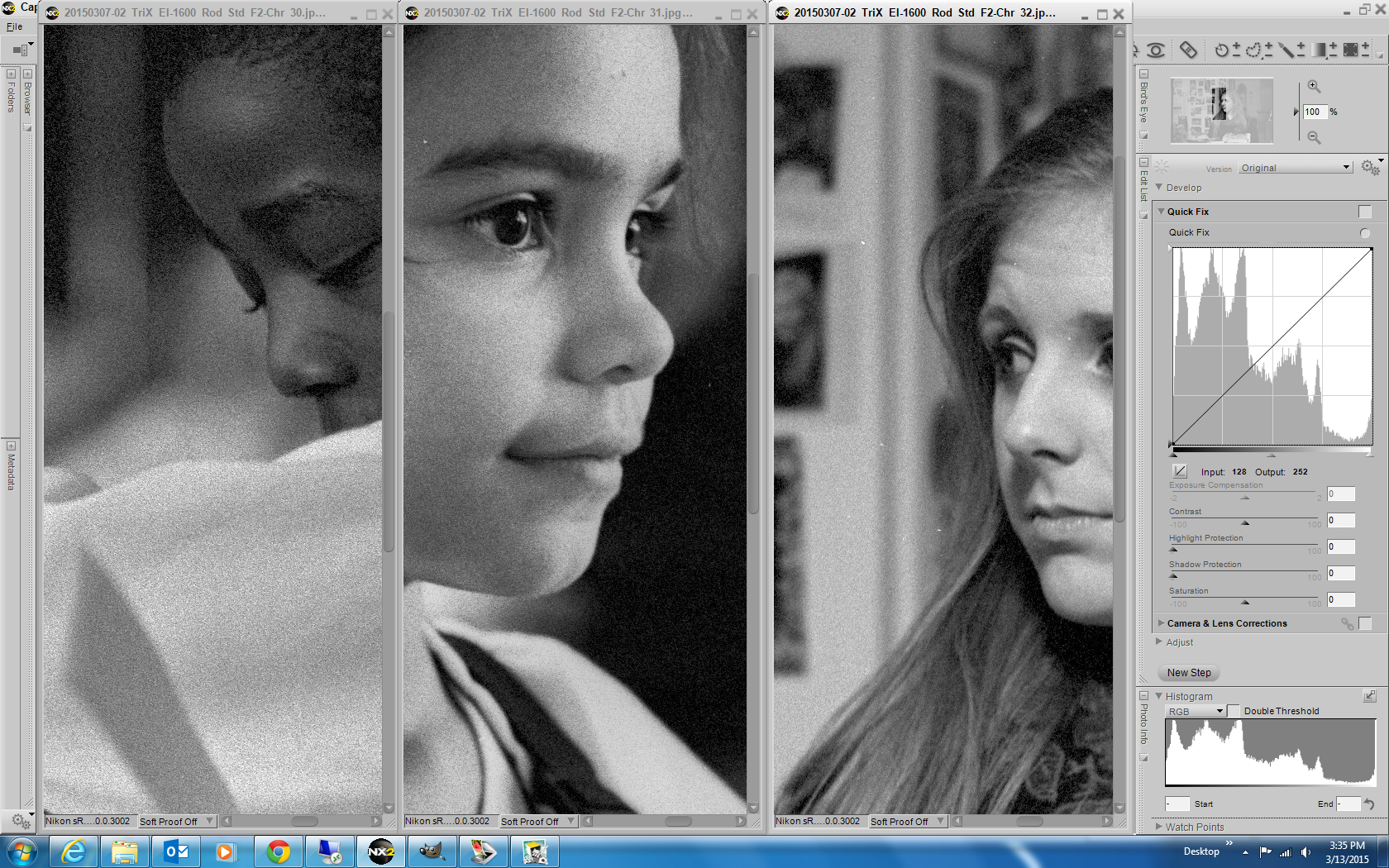

For grins I did side by side comparison like Athiril did. This screen cap shows a frame from three different rolls of 135 Tri-X 400 shot at EI 1600 and developed using the following methods, left to right: L-110 1:119 Semi Stand for 1.5 hours, Rodinal 1:100 Semi-Stand for 2 hours, and XTOL full strength with a by the tech pub 2 stop push. Each frame is showing a 100% view of a 4000 dpi scan. Each frame was scanned using VueScan with grain reduction set to none and all settings equal. Pay no attention to the files names, I was too lazy to change the output name format in VueScan so they are not indicative of anything.

The LegacyPro L-110 semi-stand followed Brendan Comey's process posted on Filmdev.org. This was my fist try at using L-110 for any stand work so this was my baseline. I may modify a bit and try again. Perhaps leaving off the pre-soak and going a bit longer.
1 Pre soak for 5 mins at 20C (It was 72F in my kitchen at the time so I used that water temperature as well.)
2 HC-110 dilution G (syrup 1:119) (500ml of solution in a two reel tank. Film on bottom reel)
3 30 seconds initial agitation
4 1 x gentle inversion every 30mins total time 1.5 Hours
5 Water stop: fill and drain 10 times.
6 Kodak Fixer
7 30 min rinse.
8. Photo-Flo (3+1000) for 1.5 minutes.
The Rodinal started off as a 2 hour process that seemed very popular on line. I reduced agitation to once every 40 minutes vs every 30 minutes and only use two gentle swirl agitation.
1. Rodinal 1:100 or 1+100, either way there is not enough difference in concentration with this method to worry with. Room temp. (500ml of solution in a two reel tank. Film on bottom reel)
2. Initial agitation - 1 minute of slow inversions.
3. Two gentle swirls at 40 minutes and again at 80 minutes.
6 Kodak Fixer
7 30 min rinse.
What is you semi-stand agitation method?
