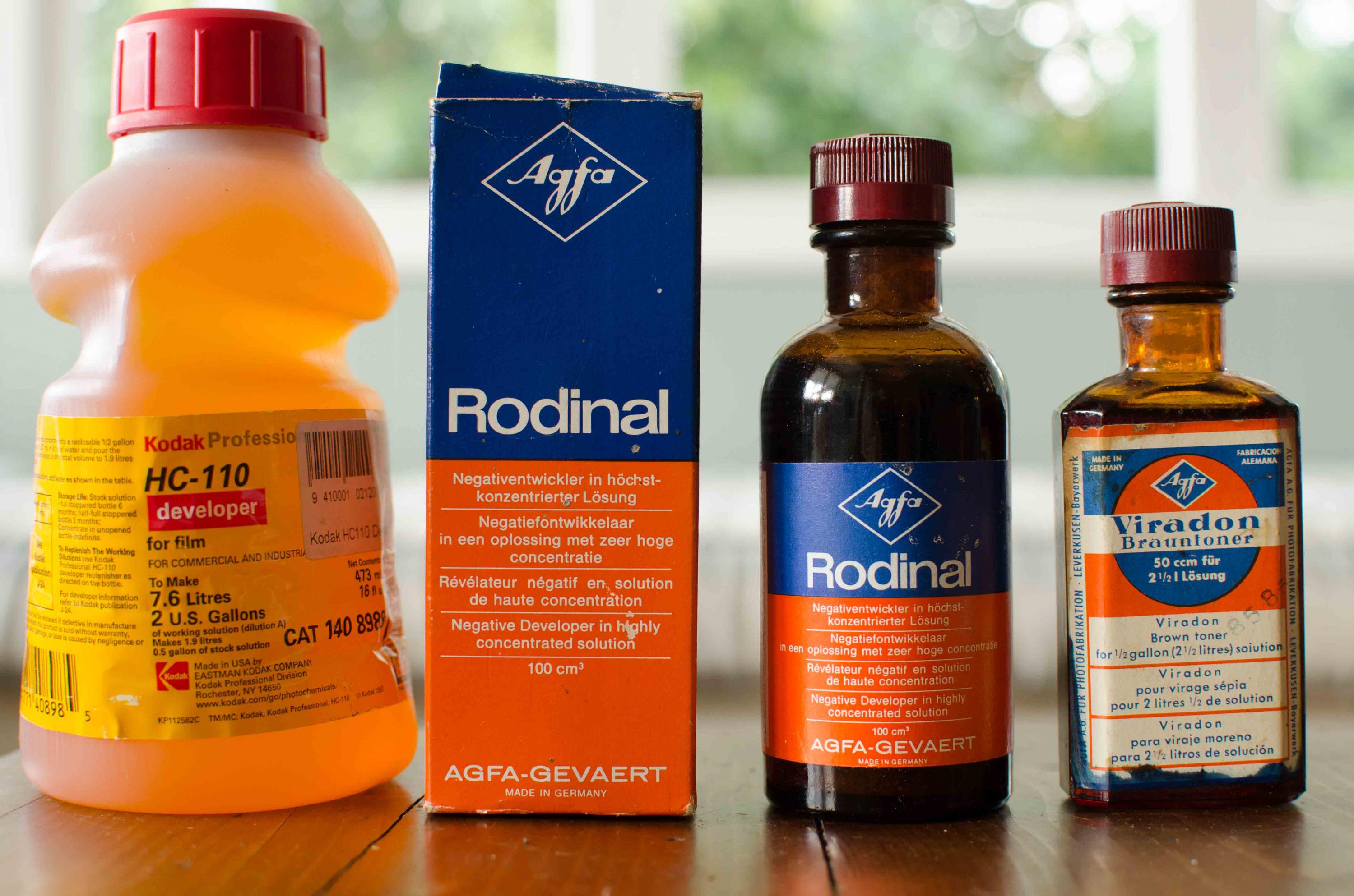

Hi everyone,
I've just bought from an elderly women her late husband's developing and darkroom equipment lock, stock and barrel. This includes some chemicals which I understand to have a long shelf life; HC 110 and Rodinal. The HC 110 has an expiration year of 2004-2005 but to the naked eye has not discolored or formed any sedement. The rodinal is unopened but has obvious concretions accumulating in the bottom of the bottle that partially dissolve, as far as I can tell, with vigorous shaking. Ive also got a bottle of viradon, which seems of similar vintage to the rodinal, but haven't read anything about it being exceptionally long lived. Can any of the industrial archaeologists out there advise me of the viability of the above chemicals and perhaps when they might have been manufactured?

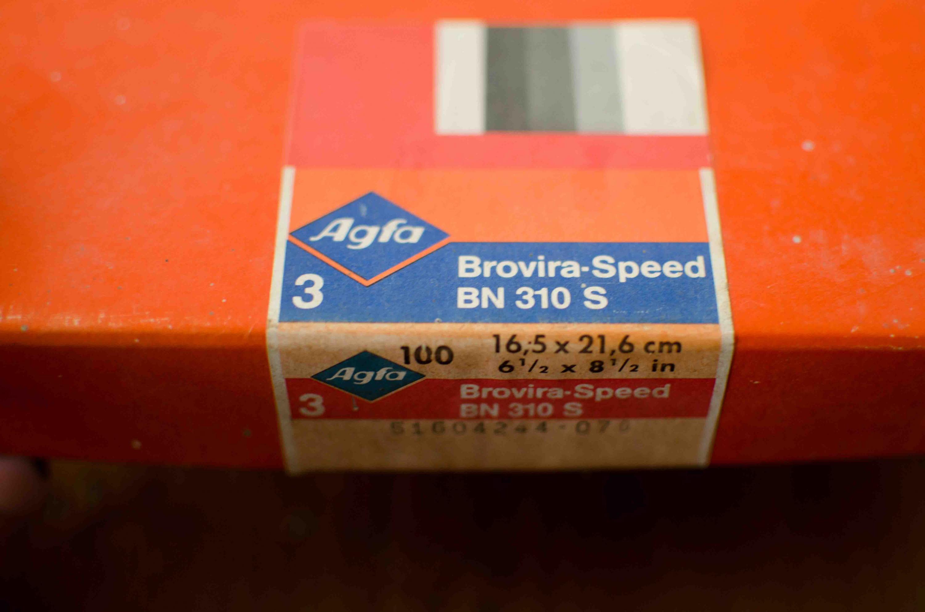

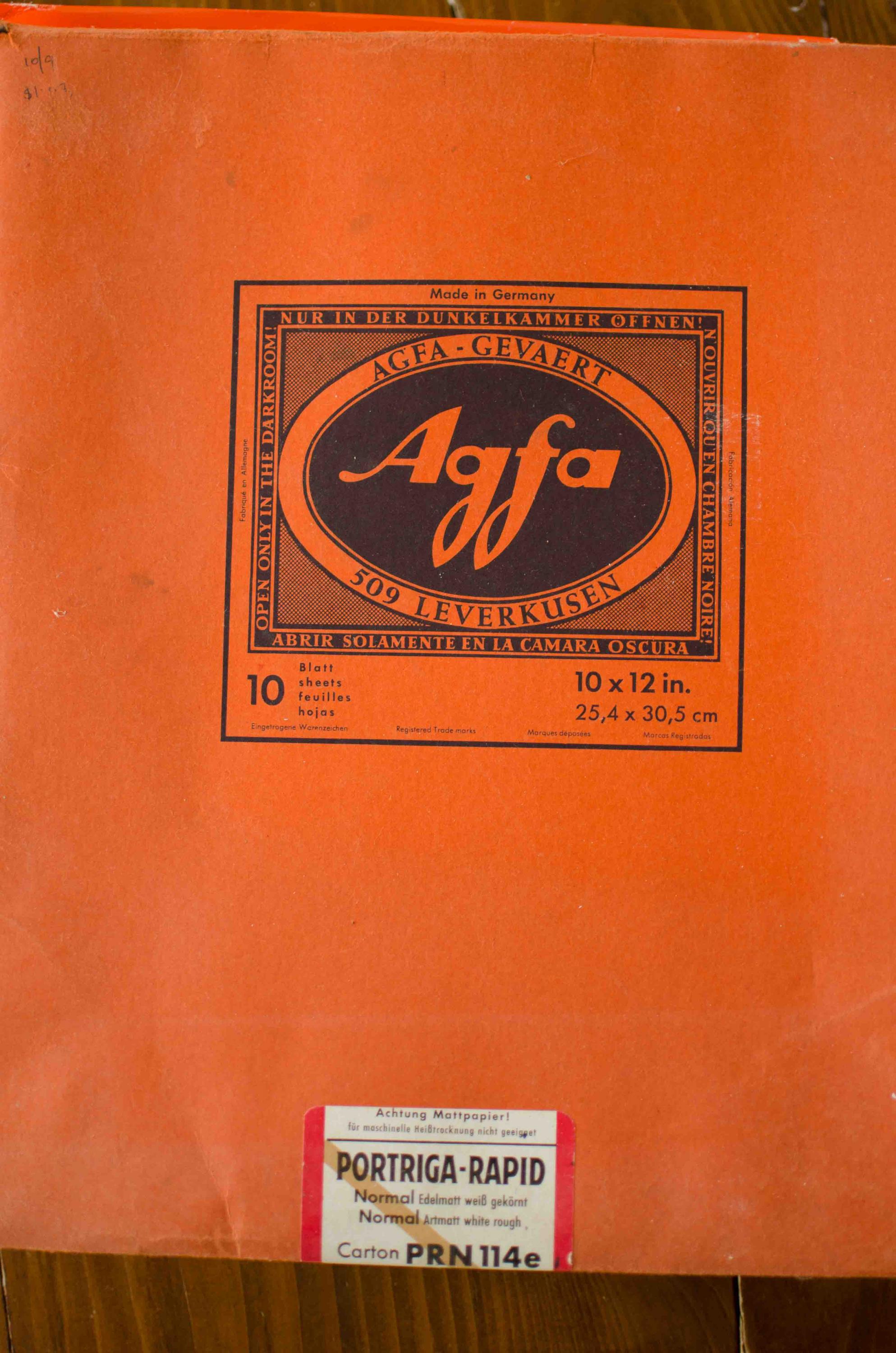

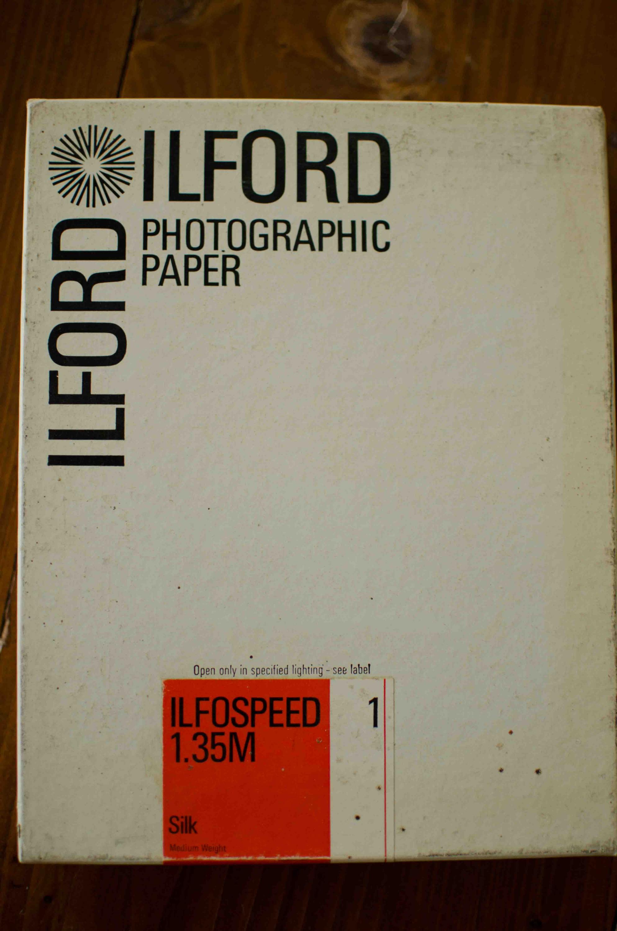

Thanks everyone for all the replies. The HC-110 bottle is puckered because the previous owner used a bit and then squeezed the bottle to expel as much air from the bottle he could. I'm fairly comfortable using that stuff. The rodinal box says shelf life in indefinite but they must mean under absolutely ideal storage conditions. How about the viradon? Dump it?

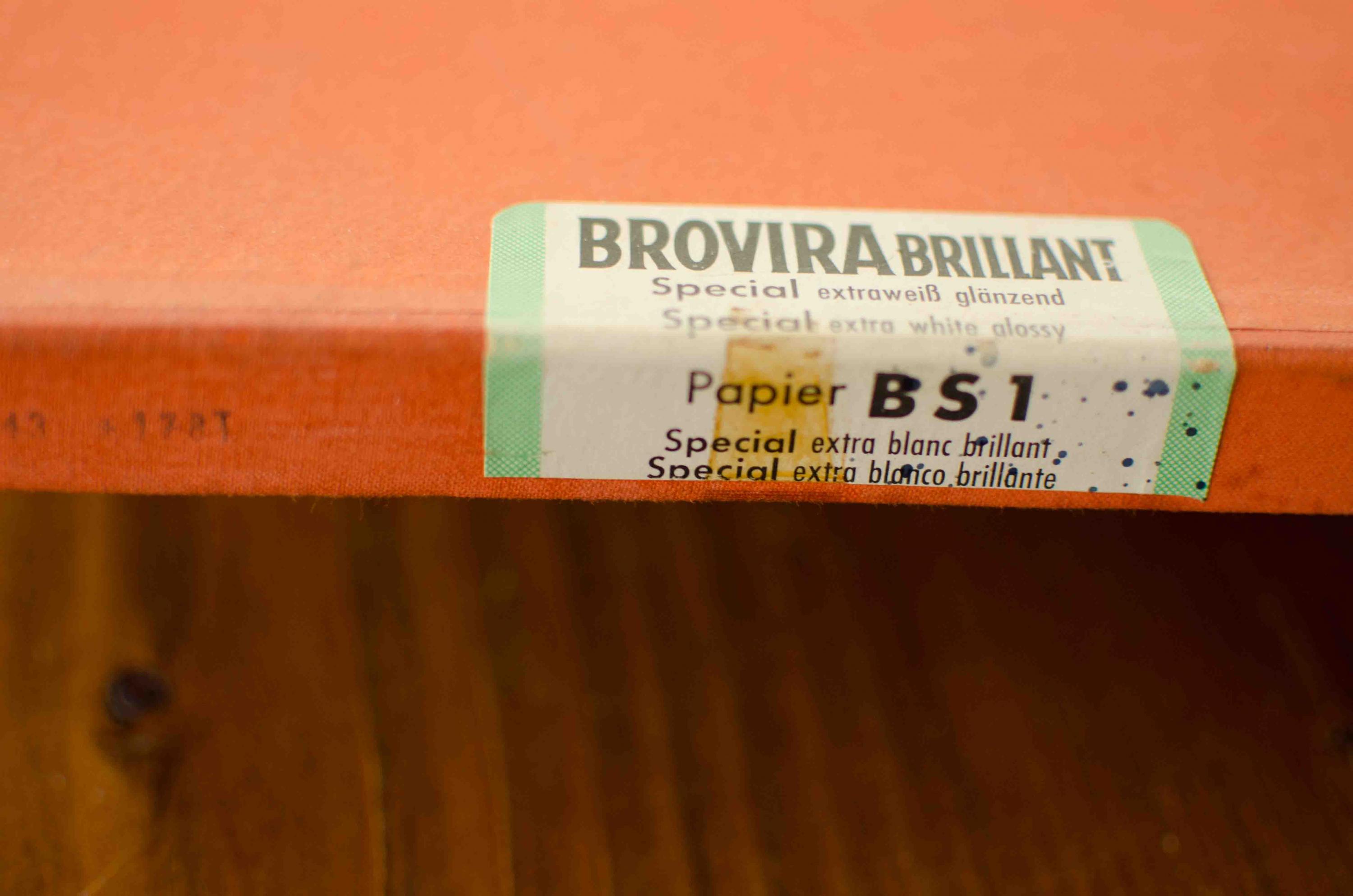

I've attached some pictures of the paper just for kicks (I've got a ton of the ilford paper). Does the packaging reveal the paper's age to anyone? Perhaps '70s for the ilford and older for the agfa paper.

The Rodinal is ok for at least 25 years in almost empty bottle, in bad temps, you dont need to shake it or filter, just decant into measuring glass as needed.
The residue if you should decant will go back into solution when you dilute 1+25 or 1+100. It an excess of preservative in the main.
Id not keep chicken BTW but the Rodinal is not subject to salmonella basically it is drain cleaner so wear kitchen gloves.

I'd certainly try the Rodinal, and would be surprised if it wasn't fine. I'd try the Viridon, but perhaps with less hope of success.
But I'd keep the two glass bottles whatever....rather nice collectables with the vintage labels.

Most likely the Ilfo-speed is long gone. The Brovira may be ok.
For the Rodinal it's very unlikely that it's not good. The bottle I had was at least that old and worked fine until I finished it a year or so back.
In addition to lumen prints, the dead paper is useful to season developers, especially for lith, or to saturate old fix to use with a silver magnet for recycling.

I'd agree on trying the Rodinal - I bet it will work properly.
I currently am working my way through a bottle of Orwo R09 made in around 1986; it is as black as coca cola, but works perfectly.

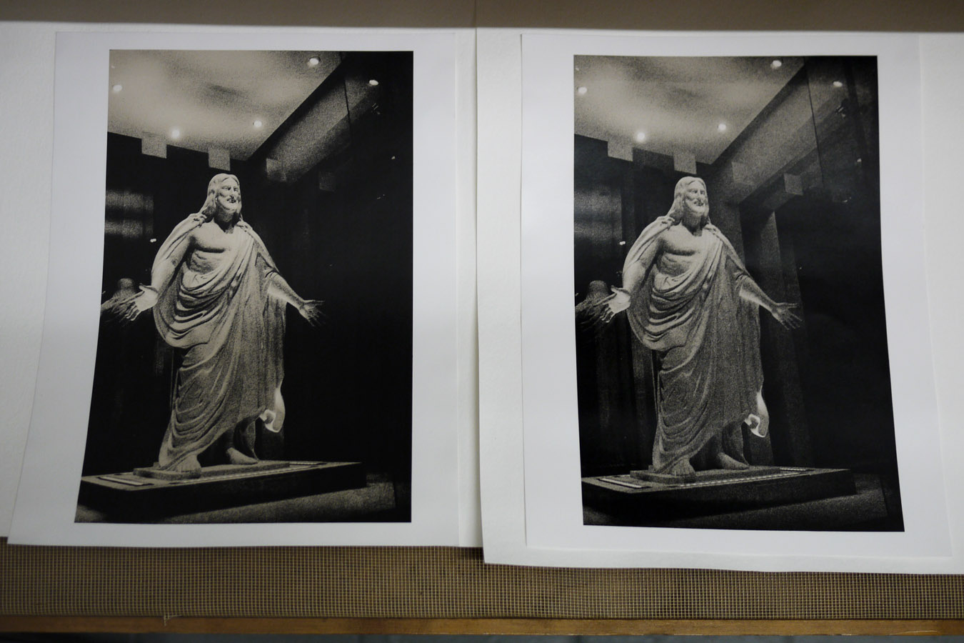

I was kindly given a box of Agfa Brovira FB some time back and had a chance to test it in lith this morning. (Low quality Jpeg attached.) Think my box looks the same vintage as your Brovira Speed, probably 1970s, though I think the Brovira Speed is resin coated. Anyway, very good reaction in lith dev. Prints shown are not amazing as was printing the image on another paper so didn't have time to experiment much, but curious to see how it would work. Quite gritty in Moersch SE5, (the wonder dev!), but lovely colours. Well worth seeing what your papers do in lith!

I was going to say this - try the paper, nothing to lose. Try some benzotriazole (BZT) maybe for the Brovira and maybe the Kbr for the Portriga (as BZT tends to cool and Kbr to warm) and see what you get, if you're in an experimental mood. Nothing to lose by trying.

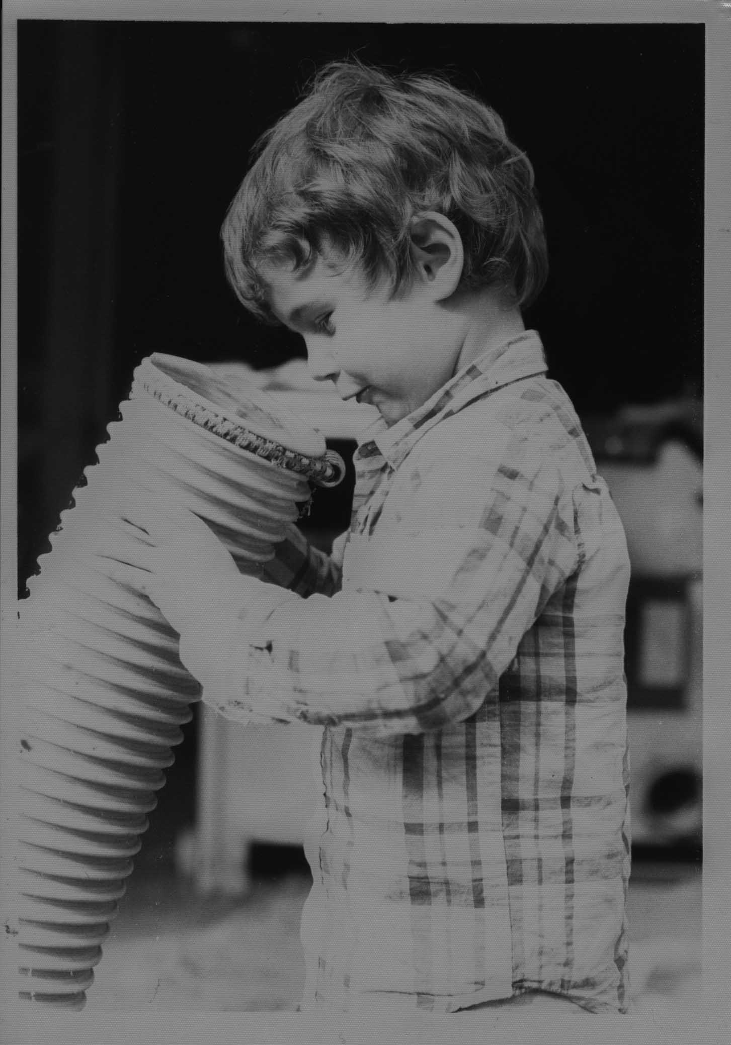

Its......ALIVE!!!!!
I just wanted to post a quick follow up to my original post. I cracked open my bottle of rodinal (and cracked I use almost literally as the rubber stopper in the bottle was so caked in place , I had to use a screw driver to loosen it and nearly broke the bottle) and developed a roll of arista.edu 100 35 mm film in 5 ml rodinal+500 tap water for 60 minutes @ 20 degrees in my styrofoam water bath, with one intial minute of inversions and two inversions at 30 minutes. Water stop bath as per ilford instructions (fill and dump) and ecopro neutral fixer. I printed the negative on a sheet of 5x7 ilfospeed 2 silk (?1980's vintage) and developed in LPD with water stop and ecopro fixer. THE PRINT IS HORRIBLE! I know! It was late and I was tired and misjudged the exposure time but I just wanted to see what my rodinal could do. And ,allowing for the atrocious print, I think the rodinal still alive and kicking. Im going to repeat the print to get it right but I thought Id share my first run. The image looks sharp and clean and I can even see (although it doesn't scan well, partly due to my feeble scanner and also the texture of the 'silk' paper) very fine cobweb strands on the edge of the vacuum hose. Im looking forward to many more rolls of film developed in rodinal but I must say that my other developer (diafine) does a spectacular job with tri-x and I'm now really happy with the rodinal and diafine combination for slow and medium speed film. Now I need to pop open my bottle of viradon!
