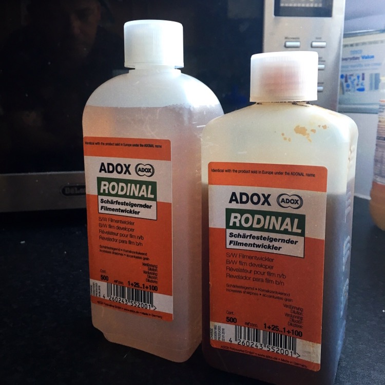

Does the colour of Rodinal vary, or perhaps darken with age? I bought a bottle and thought it looked "weak", comparing to someone else's bottle bought earlier this year it does look a lot lighter. He didn't remember his being that light when bought.

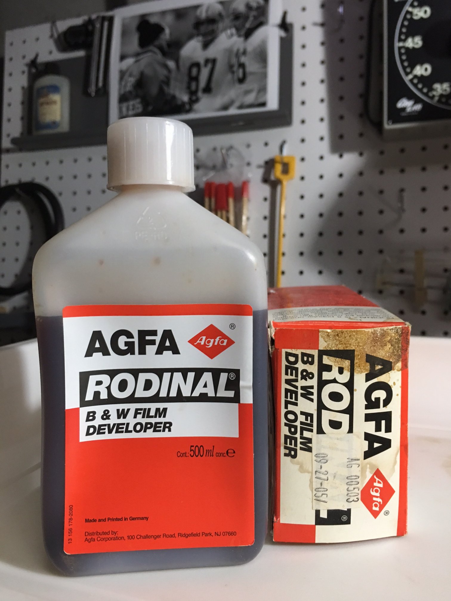

it does darken with age. Interestingly, my original Agfa Rodinal bottles are all the same exact shape, size and design as your dark Adox Rodinal - and the same dark color after 12-14 years. I don't remember my new Agfa Rodinal being that light and transparent of a color when new but it's been so long... Perhaps the color of new Rodinal has changed?

I've never seen it that light in colour. I'm told the darker one was bought in about March this year. The place I bought it from took offence just from me asking about it and said if I'm not happy with it send it back. Not overly helpful of them.

Rodinal is clear when it's fresh, and it gets darker over time. Don't worry! That bottle is pretty fresh and will be usable for 20+ years.

The initial color of Rodinal is effected by the purity of the p-aminophenol used to make it. For awhile manufacturers were using a low grade chemical and the resulting developer was very dark. I was surprised at the light color of the Adox product.

The lighter the initial colour, the more expensive ingredients went it, says Mirko of Fotoimpex (what Gerald wrote essentially).

Here's the color of my bottle of original Agfa Rodinal, and the matching box it stays in in dark storage. The box states 9/27/2005, used some a month ago. It's still going strong and coming up on 11 year birthday next a week from this coming Tuesday.
