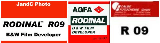

Unfortunately John at J&C tried to pass off Calbe RO9 as genuine Rodinal by selling it packaged to look like the much later Agfa version, Agfa had neglected to keep the Trade Mark name registered it's now owned bt John.
This deciet has meant that no-one can now use the name, hence the confusion. It's also sold as Blazinal.

I think Agfa threatened a major lawsuit which they'd have won, you can't pass a product off as something it isn't. You'll see J&C's packaging has the same colour scheme, pretty much the same Rodinal type face etc, I doubt Calbe were very impressed either. Then J&C also sold a lot of dodgy EFKE materials, essentially substandard with coating defects as well as miscut chinese LF films that wouldn't fit DDS. All in all not really a company you'd want to trade with.
Ian

John did seem influential for a while though, turning up at that APUG "conference" in Canada a few years ago.
Tom
