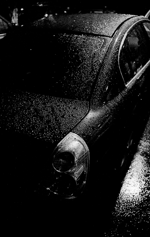

I developed a roll of Tri-X in Rodinal 1+49 (I keep going back and forth on proper syntax here, 5 ml Rodinal to 245 ml water). My development time was 12.5 minutes with 30 seconds of initial agitation and 4 inversions at the start of every minute.
I was rather happy with this shot that I just scanned. I'm not sure if this is just composition itself, but I do like the tonality in it and maybe I'm seeing the "glow" people seem to refer to.
-jbl
JBL
I would not recommend Rodinal for 35mm Tri-X unless your trying for a certain effect and wish for grain. Your development time is about 2.5 min longer than the charted suggestion of 10 min at 20c. If you are scanning film the combination is bad. On the other hand Ralph Gibson http://www.ralphgibson.com/ uses Rodinal with 35mm. His images are contrasty and often show some grain.
