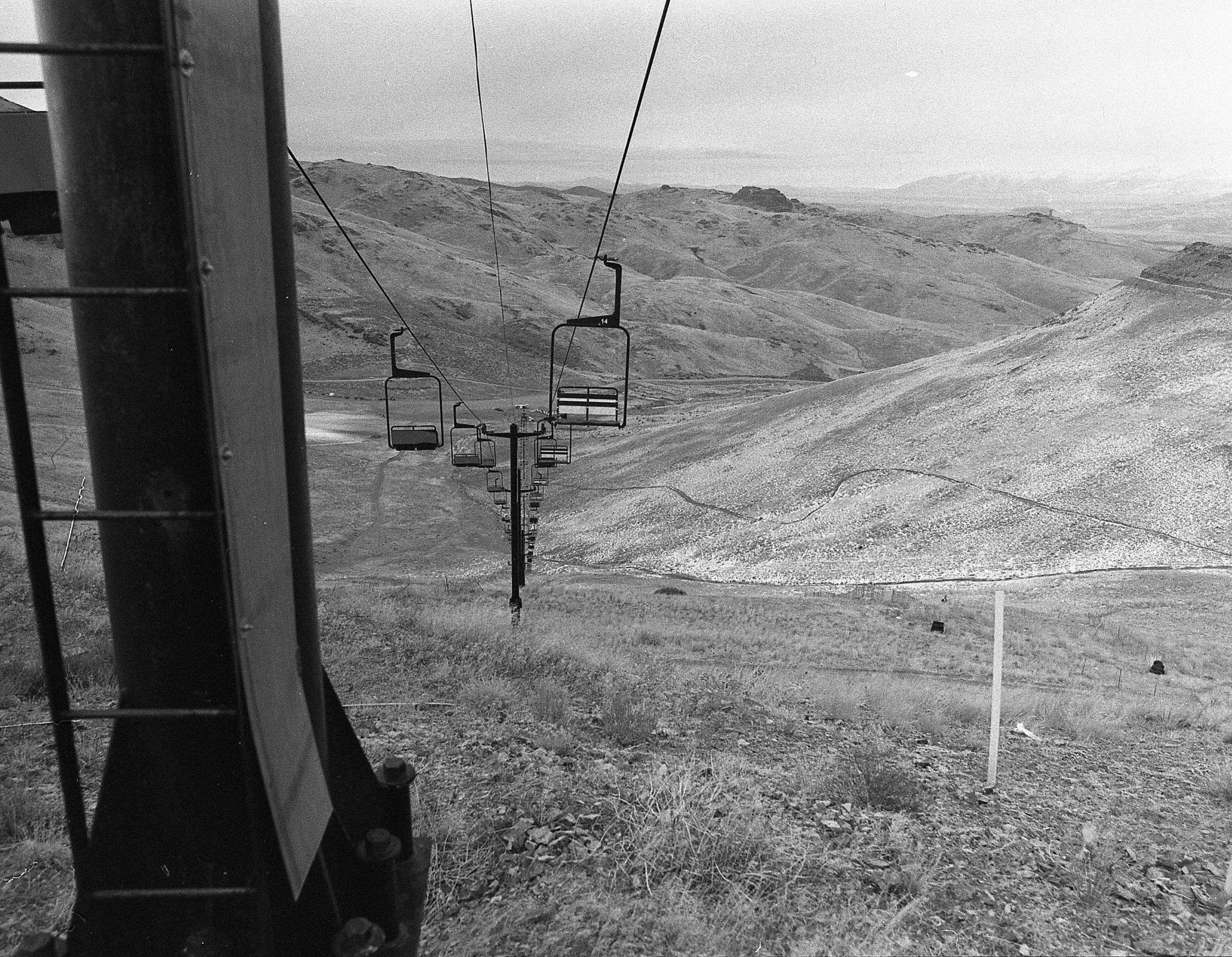

Here is one of the negatives from that run.

I think I see some definite edge effects in that image - course I don't know whether that has anything to do with the scan.

I would agree with Matt re the light sky area in the upper right. I see this with 120 film if not careful about agitation with semi stand, with Rodinal. It occurs mostly in lighter areas (Z6-7 and up). It's as if the agitation at the edges (especially the top edge of the reel, where exchange is better than at the bottom) is greater than in the middle of the film. My agitation for semi stand is for 20 seconds, slow and steady, inverted with twisting motion.Seems to take care of it, most of the time, and, as pointed out, depending on the film.
There is already a lot of info in this forum on stand development, you can find it by searching for it. Many people have greatly varied experiences with it (stand and semi stand), your best approach is to do testing for your own set of circumstances.

One thing I have noticed lately - not yet proven, is that high dilutions may yield more edge surge effects. Not sure of this yet, but I keep very good records of what I do for each roll of film.
One other tip - you will waste (in some sense) a roll of film, but if you place the camera on tripod very close to a light colored evenly lit wall (inside the house will work), focus on infinity (not looking for detail here), and place the value of the wall on zone 7 or 8, and fire off all exposures, then develop with your method, then print on grade 3 or higher - but print the value down to maybe zone 5, you will see the surge. A contact sheet is best. You might be shocked. When you can develop a consistent and uniform roll this way, you've got it.
