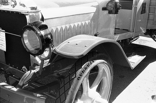

Here's 35mm .EDU Ultra 400 (rebranded Fomapan) processed in Parodinal (homebrew Rodinal made from headache tablets) at 1:50.
Shot at box speed with Canonet 28 (yes, that's 35mm). Sure, it's grainy, but Tri-X would be grainy too, all else equal.
