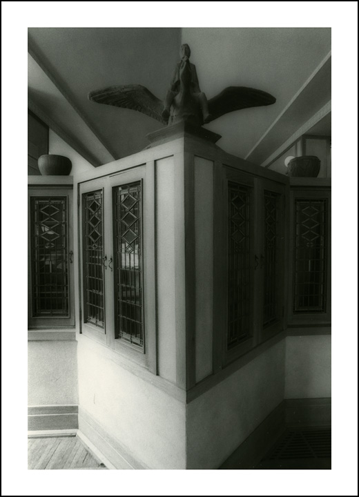

For my own purposes, to make the grain look its best, and to get razor sharp prints, and finally to get the midtone qualities I want - intermittent agitation.
I develop all films the same way, and they are exposed between box speed and one stop overexposed usually. I hear Foma needs shorter development times.
30 minutes, agitate continuously by rolling my daylight tank on the floor for the first 90 seconds, then two gentle inversions every 5 minutes.
Dilution: 1:200 using 500ml per film.
Temp: Starts out at 70*F, then it depends on the room temperature what it ends up being.
Rinse and fix. Fully developed shadow values. Glorious midtones. Awesome local contrast. Grain that is beautiful both in 35mm and 120 formats. Highlights that are very easy to control during printing. Basically, it produces a negative that prints easily and is easy to manipulate. To emphasize on Don's 'what's for lunch' analogy - you get a five course meal that you can choose to devour any way you like to. :D
I have attached a print scan from an Efke KB 100 35mm neg. I used diffusion while printing, so the grain isn't really apparent. Ilford MGWT fiber glossy, developed in Ilford Multigrade 1+9 at 68*F.
I hope that helps. But I concur with Don - tell us what you have found to give some substance to the thread.
