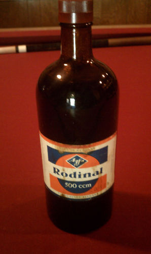

I've had opened bottles for over 10 years that I used with no issue. Bought one on ebay not long ago (old yellowing white plastic bottle) that was taped shut and only had 2/3rds left, no idea how old it was, where it was stored (person selling found it at a garage sale) or how it was stored, and it worked fine. Just got a hold of this one lately (attached), it's unopened and looks REALLY old. Will try it soon (but I figure there's no hurry at this point!)
