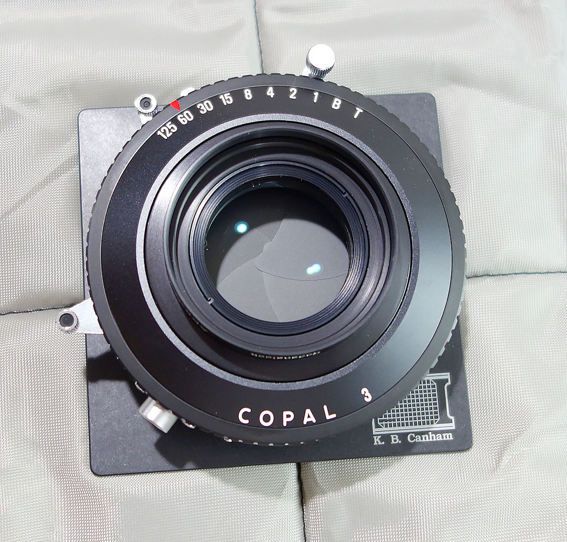

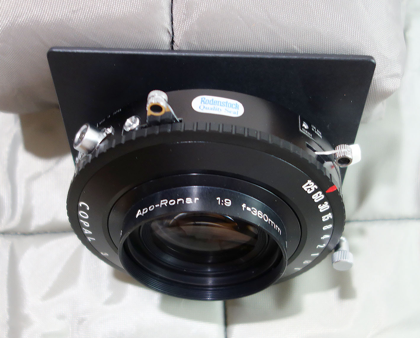

I had a 360mm Apo Ronar in a Copal 3 shutter and it was beautiful for 5x7 shots.
