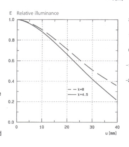

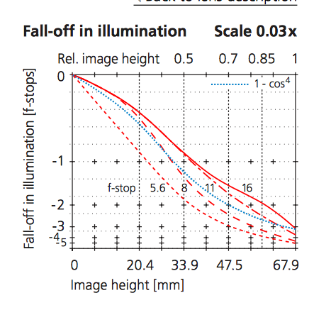

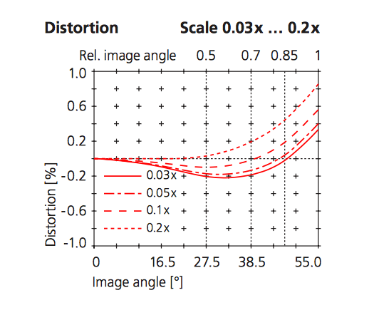

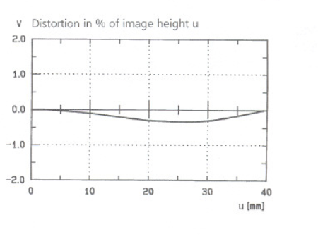

Anyone have experience of either Apo-GrandagonS, the 35 mm f/4.5 and 45 mm f/4.5?
How are they on MF with distortion?
Top is for the 45mm Apo-Grandagon and its competition the 38mm Biogon below:
Use caution comparing side-by-side, as the 38 Biogon data is for 6x6cm coverage only (80mm diagonal).
