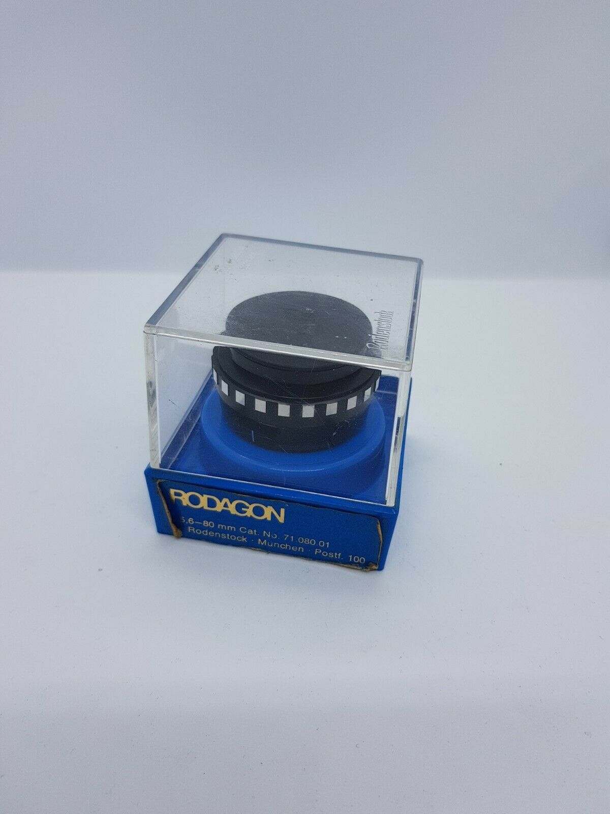

Hi All - just purchased a Rodagon f/5.6-80mm Cat No 71.080.01 s/n 9267043 and I gust it would have a filter thread of 40.5mm but it is more like 35.5mm.
I purchase this lens to use on a slide copier rig (Pentax bellow, auto tubes etc) and need a step up ring to get to M42mm of the bellows.

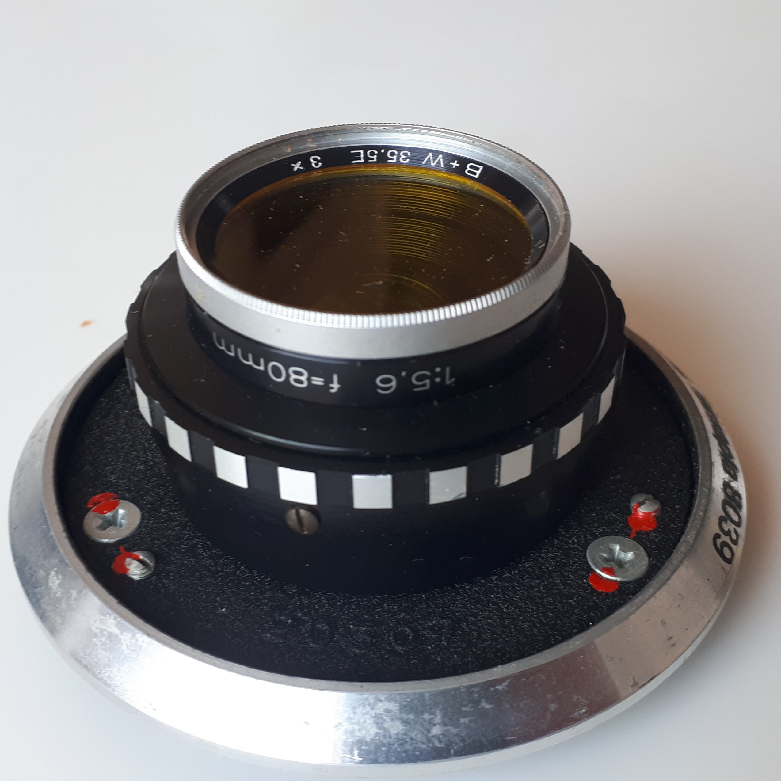

Hi, I think this is what you're looking for; an old style Rodenstock Rodagon 80mm f5.6 fitted perfectly with a B&W 35.5 filter.
