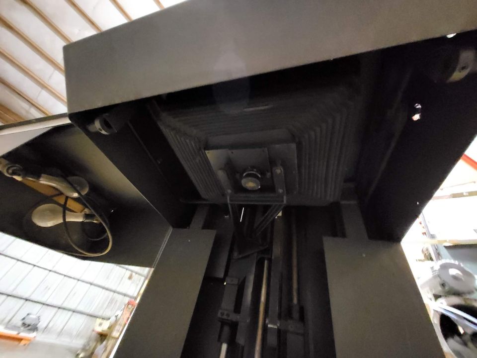

By the pictures the lens is there. What condition the lens is in I don't know. If I'm fortunate the lens will be usable. Only way to find out is to go look at it. The photo actually doesn't show very much. Thanks to everyone for the information. Appreciate it! 🌞

I'm almost certain that's a Goerz, leather lens cap. Their logo was a golden stamp of sorts. May be worth going out in the storm. Good luck. Look for other goodies, timers, plate burners etc etc.

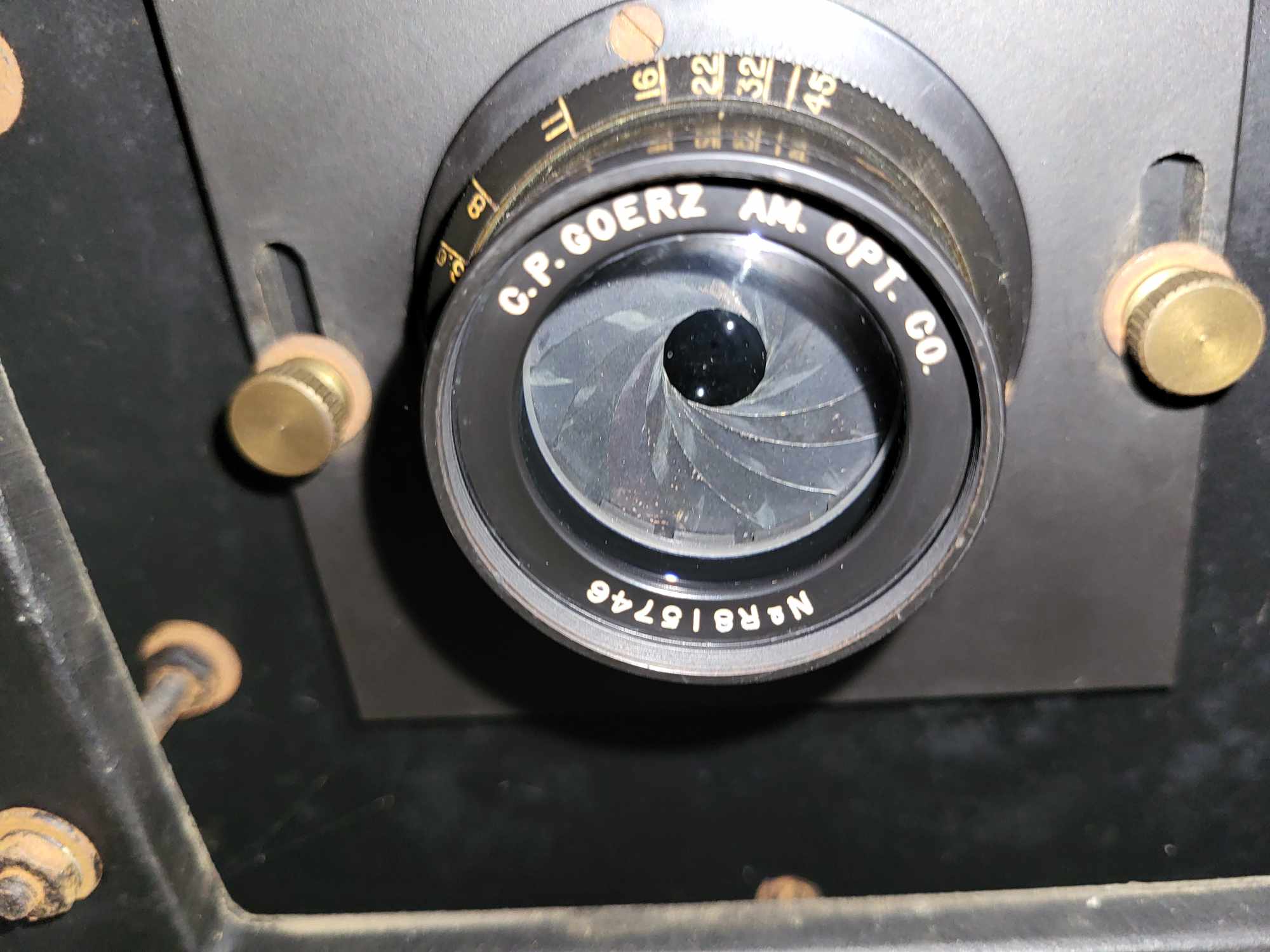

I haven't made it down to check out the Robertson camera yet, all kinds of things are happening. But the seller has sent me some photos of the lens. Would this lens work on an enlarger? It is a Goerz, as per the photos.

Probably way too long focal length for the average enlarger though it would be great to use if the camera was converted to an enlarger.
