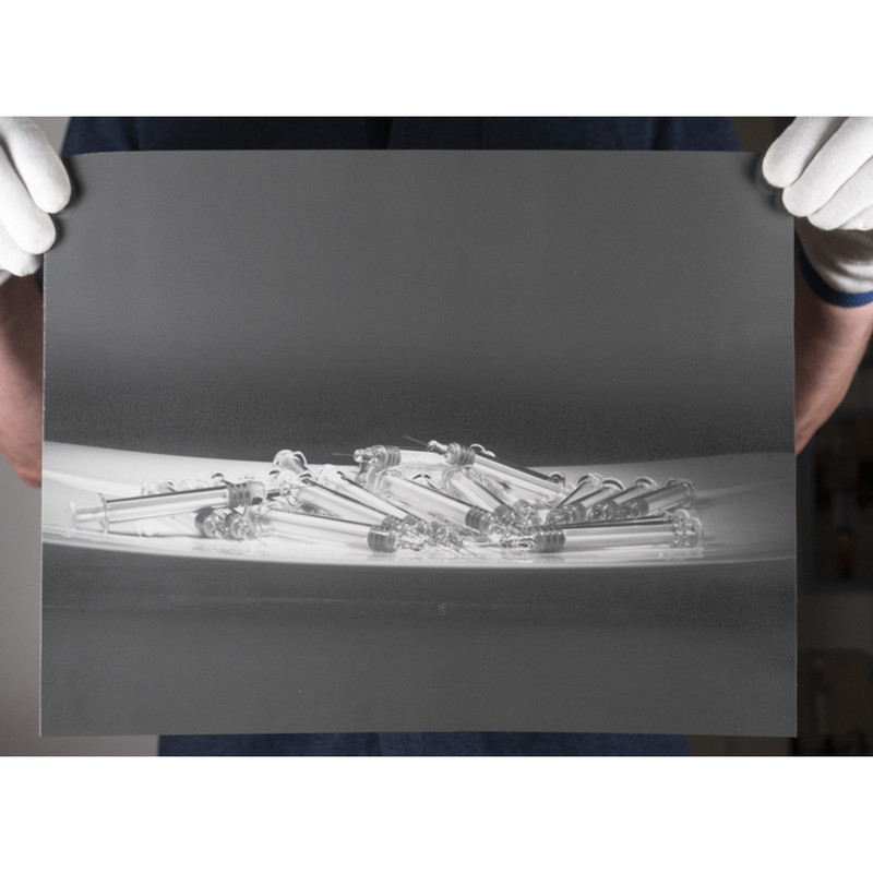

I just completed the profiling of a couple of widely available papers (Ilford MG RC and FB) used in-camera and then inverted using “Roba Apposta” by Branco Ottico, an Italian company. “Roba Apposta” is a reversal development process sold as a kit that works for both film and paper. I used it only with paper.
I wrote a paper on this profiling. Here is the link:
https://www.marcoannaratone.photography/Tests-(PDFs)/thumbs
I included below an example from a project I just started (“Syringes”). It’s a 14x17in cut from 16x20 and used inside my Lotus ULF camera. G-Claron 355mm @ f/45.5
I have no relationship with Branco Ottico so I suggest you have a look at their site if interested:
http://www.brancoottico.fineartlabo.com
Cheers!
