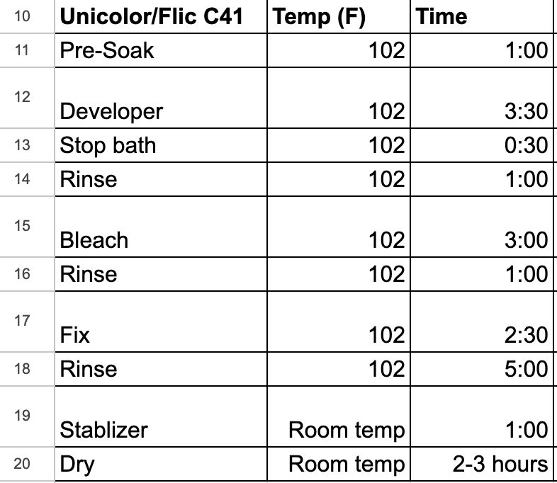

I'm using Unicolor/Flic C41 kit, and reusing chemical (I premix 1L working solution, and store them in two 500ML aluminum lined wine bags). Thus I rinse after stop bath, and after bleach.

Flic uses ferricyanide bleach! It's very intense - you really need a good wash. They also use acetic acid instead of mineral acid, it's safer, but there can still be a problem with the film if the cleaning bath isn't enough.
