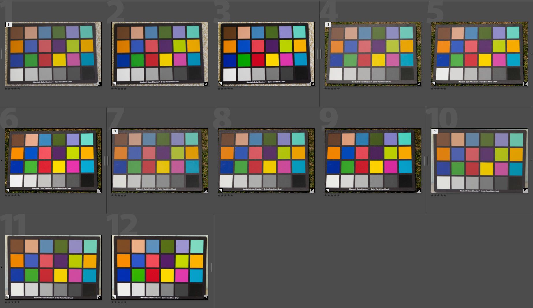

I find the colours are so washed out that the lab tells me they're pretty much useless for shade matching. In fact the owner of the lab tells me photography in general isn't of much use to their lab techs and they prefer to book custom shades. I wasn't sure if this is because of the quality of photos the lab gets, if they just wanted to drive up revenues with the cost of a custom shade, or if monitor/camera colour calibration was the issue. .
The issue of color matching is a common one, as usually there is no reference patch to use as a universal indicator of color neutrality in a shot! Simple example:
Which ONE of these twelve renditions of a ColorChecker card photo is accurate? Look at the skintone patch (#2) as a simple example how widely things vary!​
Would you trust a lab to 'match this color'??? Even with a 'neutral' grey tone (in all shots bottom row, #4) included and looking to be quite neutral, the skintone patch can still be very variable nevertheless. And if you viewed on the monitor on another desk, would you decide the same numbered photo below is 'most accurate'?!
And THAT is why the lab prefers that each dentist look at a standardized book of enamel tones, and simply say "Make a tooth like sample 15!"...the variability of photo color balance from shooting thru viewing is eliminated! Because sample 15 looks the same in everybody's book, and you matched the tooth in your office to sample 15.
