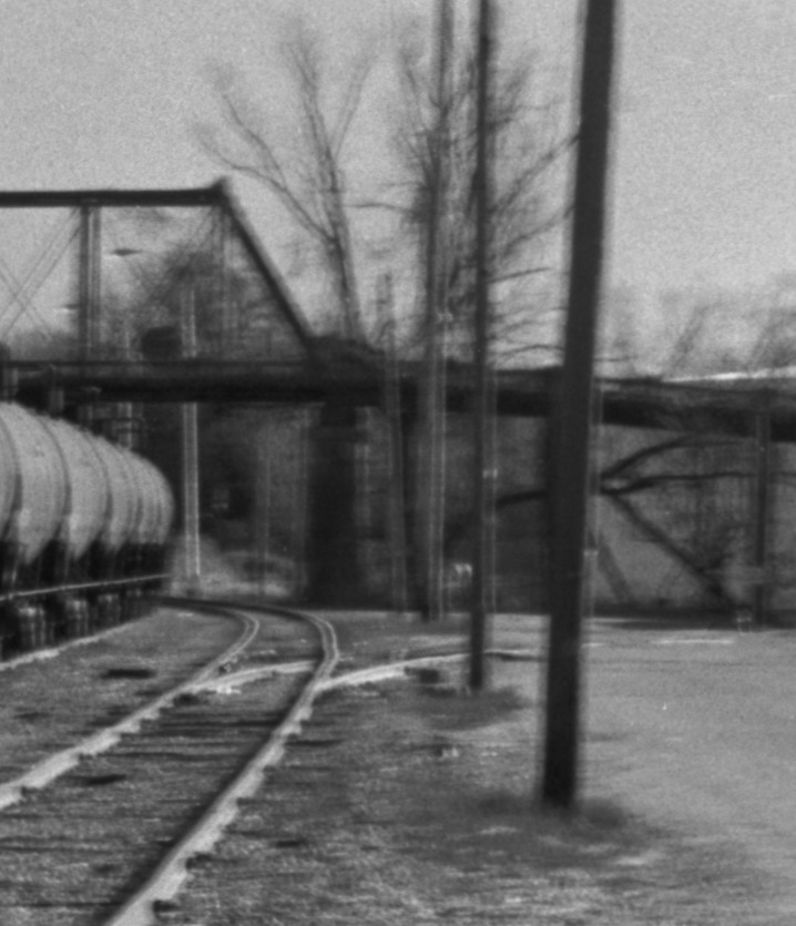

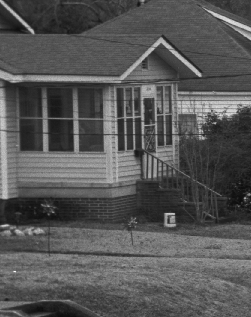

I have been exercising my Leica IIIC and noticed that sometimes, the right side of a frame, when I hand-hold at 1/100 sec, has a form of double image or jitter.
1. Tripod-mount slow exposures: no issue at all. See the example of an old car in a junk yard. 1/10 sec, tripod, Jupiter-8 lens.
2. Hand-held at 1/200, looks all right.
3. 1/100 hand-hold: 5 examples on two roll of 75 exposures total. Please see the view of a street in town. The left is fine, but the right has the jitter. The same is with the railroad yard, with the right showing the jitter. (no sharpening on these crops)
Am I mashing the shutter button too hard? Is it possible that as the shutter curtains start moving across the film gate, the camera is still, but when the curtains get to the left (from in back of the camera), I have vibrated the unit?

That's a lens issue, not a shutter issue. A smaller aperture likely hides it just enough that you don't think you see it, but it's still there. The junkyard image, even without a crop, looks a little off on the right. Possibly a decentered element, misaligned barrel, maybe even a bent camera body unless you have another lens to verify the problem doesn't exist across lenses.

Correct, if it was a shutter issue you would see unevenness in exposure.

Shutter bounce? I don't know which direction your camera's shutter curtains go, but if the jitter is at the far end of their travel the second curtain could be bouncing a little.

If you are behind the camera body, the shutter is moving from the right side to the left. So the left is the part of the frame where the jitter or double image occurs. This becomes the right side of the negative, as I demonstrated above.

I suppose then that it is possible that the shutter is bouncing as Dan said though it's approaching 1/4 of the frame and would be a pretty hefty bounce. All of my cameras have vertical, leaf or L to R shutters so I wasn't thinking out could be possible.

I have had good experiences with Soviet m42 lenses, but my experiences with L39 lenses is mixed. I would try another lens if possible. Does your lens feel loose? I have had issues with blurriness on the right side of the image with a bad lens, but it was blur not jitter.
Since you still have to press the shutter button even on a tripod, user error is less likely - if you are pressing to firmly, the entire image would be affected. Getting a camera CLA/repair doubled the price of my IIIc but was worth every penny.

UPDATE: REPAIRED. Don Goldberg said one shutter curtain had some gummy material on it.
"The issue with the 1/100th speed not working out was due to the 1st shutter curtain, it was very sticky and just was unable to do what it's supposed to do."
Don replaced the curtain and, as part of the process, overhauled the body. Now I have a pristine and smooth IIIC. Feels great!
