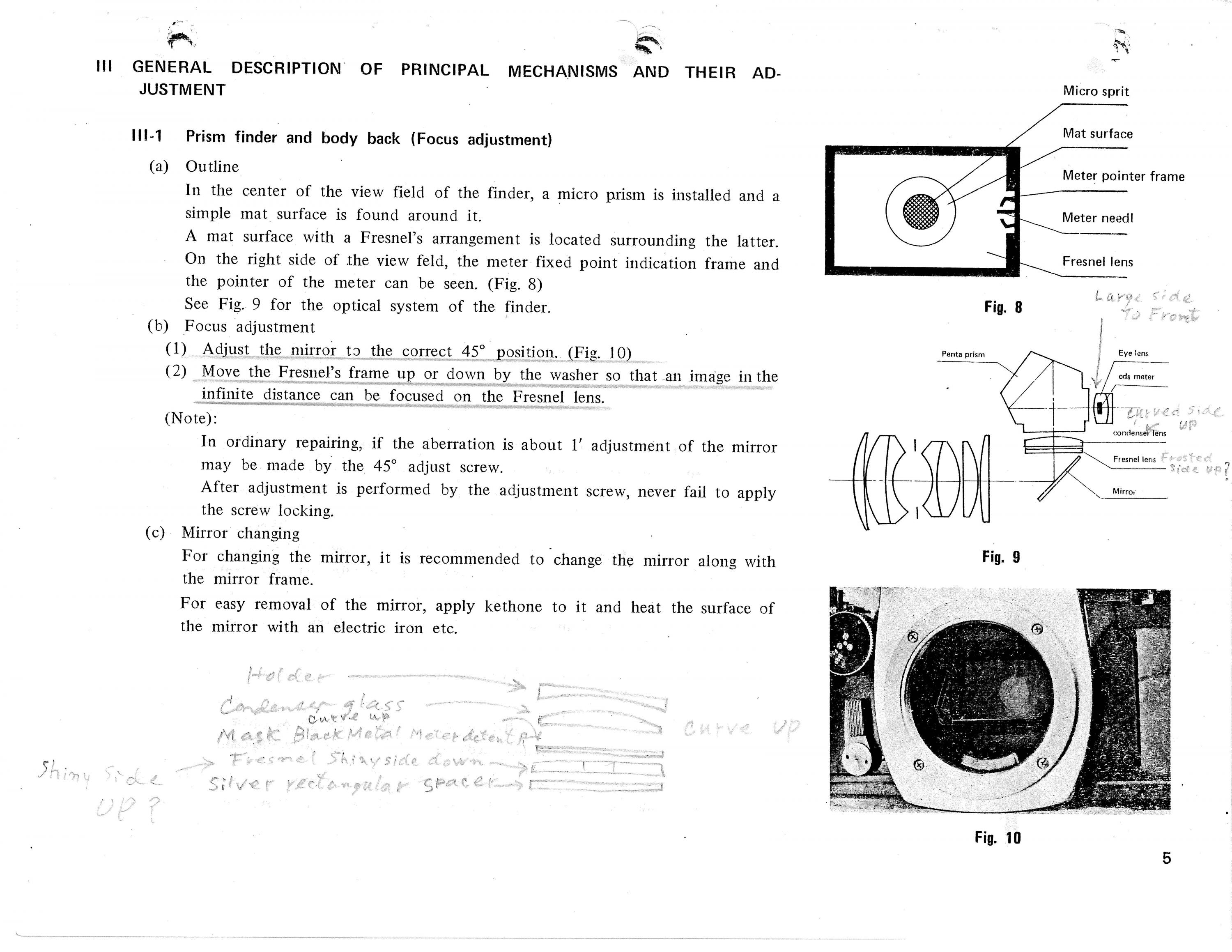

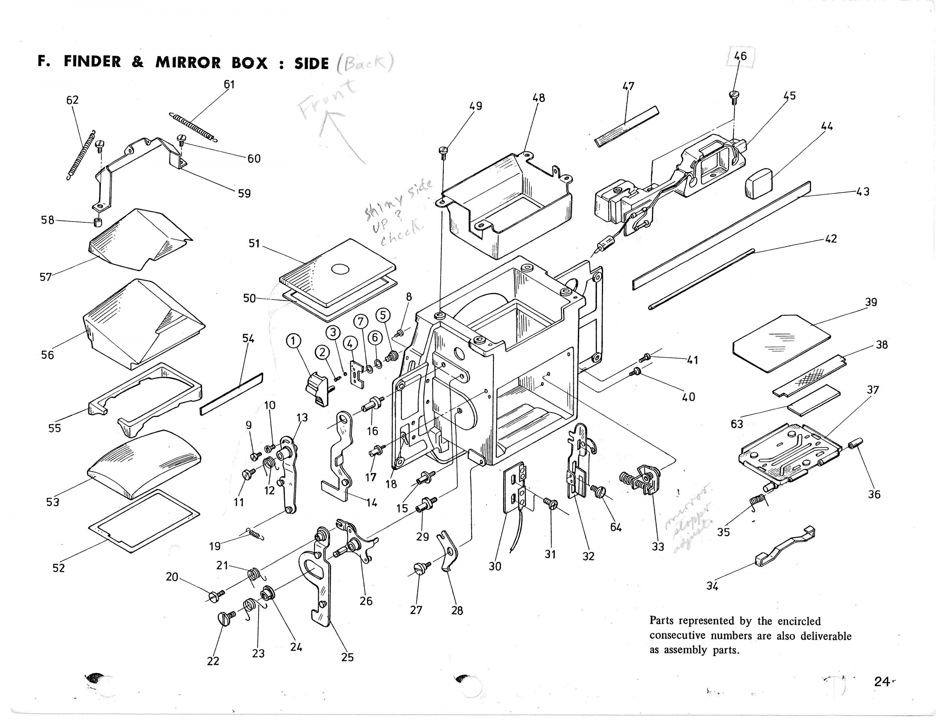

Unfortunately, I do not have pictures at this time, but I need help assembling the viewfinder/prism 'bucket' in the correct order. It was working just fine until I took it apart for cleaning before a trip. Apparently, I assembled it in the wrong order, because all my pictures are front focussing by almost a foot. Lens has not changed or been damaged.
Parts that go in the viewfinder prism 'bucket' that sits right above the mirror:
- focussing screen (fresnel side facing mirror or viewfinder? - I'm fairly certain its original orientation was with the fresnel side facing the mirror)
- very thin steel spacer (thinner than a piece of paper, no identifying marks for orientation)
- thicker aluminum spacer
- lens
- lens bracket/spacer
- viewfinder prism

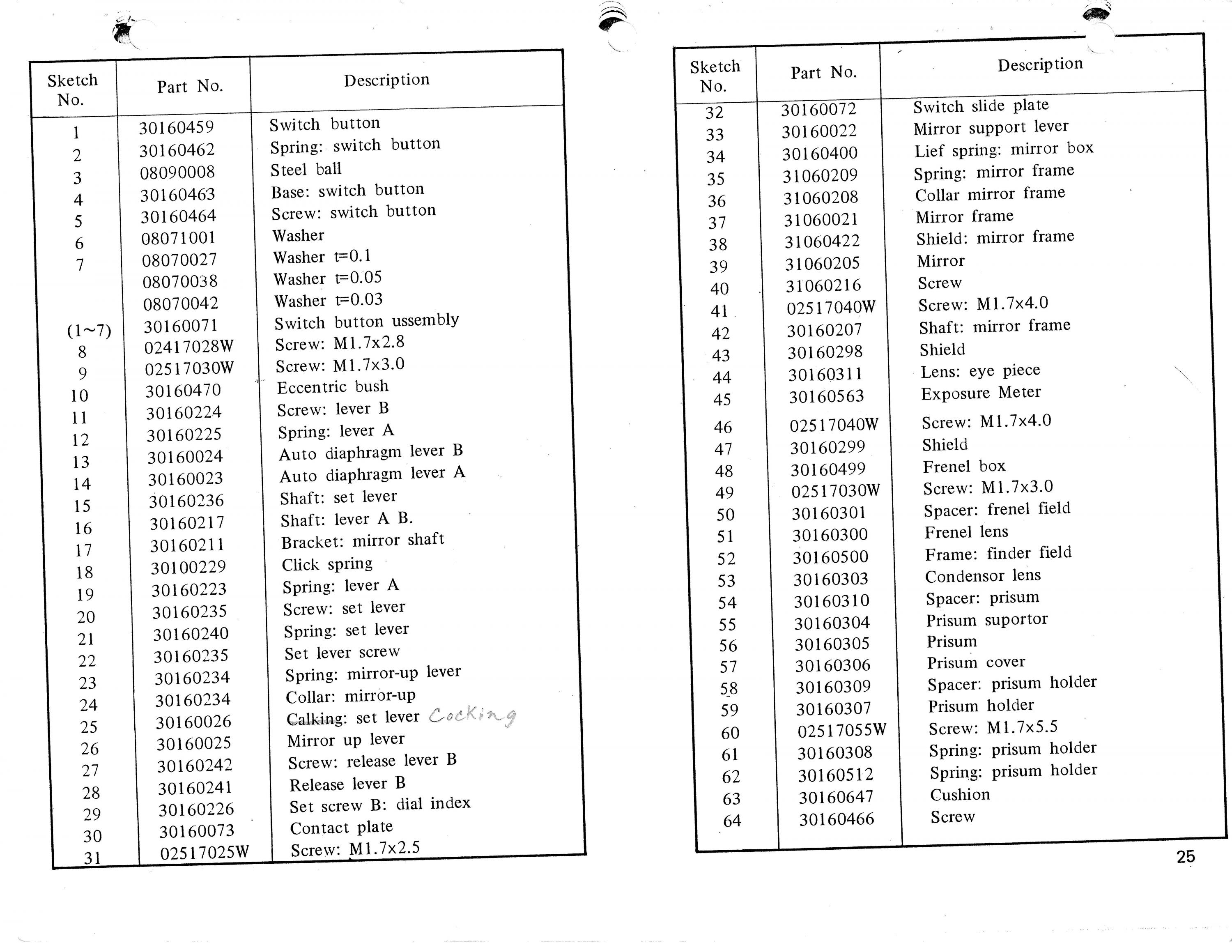

Assembly drawing from Ricoh Singlex TLS Repair Manual
See attachments ... good luck!
Wolfgang

another page that might be useful for adjusting focus
again, good luck.
Wolfgang

You might have put the focusing screen in upside down (wrong side toward the mirror).

I got it reassembled in the correct order (fresnel side facing mirror, matte side facing prism).
I put some frosted tape across the back film plane to simulate ground glass (works when you're in a bind/hurry). It looks like that did it. The distance scale on the barrel now seems to be accurate, and the focus seems to be the same through the viewfinder and on the film plane.
I've got some B/W I'm shooting at wide open (f/1.4 - f/2.8 max) as a test roll. We'll find out in a few days if that was the trick. Again, thanks a TON!
