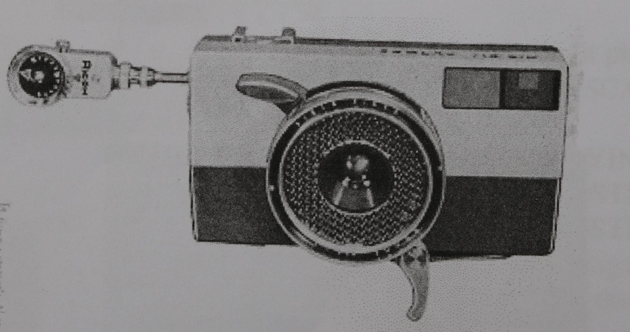

Here's an image from the brochure of the self timer attached to the camera. I've tried to find one but, as expected none for sale. I suspect they are probably 10 or more times the price of the camera..........just like the Konica X-14 flash I looked at.......£8.50 for the Konica C35automatic and £124 for the flash.

An Autoknips or similar should also work, since that appears to be a standard cable release socket.
