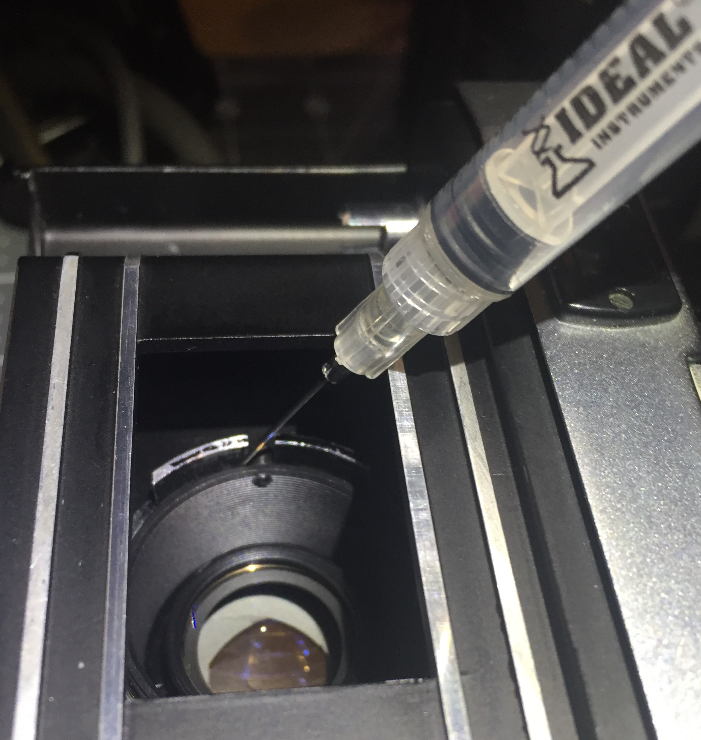

Mr. Kino, How did you dissolve the helicoil grease? Did you disassemble the lens? Is there a way to get solvent in there without such disassembly? I guess I could immerse them...seems a tad dangerous. I have two beautiful machines, both frozen; and two junky ones, not frozen. I have tries injecting solvent in from the backside because one can see the lens move. No luck.
Any advice?

If you can get the lens down to its naked helicoid(s) - no shutter, no glass, no aperture - then you can try softening the grease with some gentle heat. Put the oven on warm and bake for 15 minutes and see if that allows you to unscrew the helicoid elements. Sometimes you can only get the threads to move a little bit. If so apply some light oil or Ronsonol and try and work it in, reheat, re-apply repeat ... curse, cut finger, etc..
Be sure to scribe lines between the helicoid elements and the focusing ring. As you carefully unscrew the helicoids scribe more marks so you know on which thread to reassemble the lens.
Regrease the helicoids with, of all things, helicoid grease, available on Amazon; I use "Japan Hobby Tool #10", can't say it is anything special.
Any advice?
I had to remove the lens/shutter assembly entirely, disassemble it and use acetone and other nasty solvents to clean it off. It is very hard to do this properly. Alignment of certain pins and levers internally is hard to obtain properly.
If you have the money; sent it off.
However, you might be able to get it unfrozen by heating the lens barrel with a hair dryer to the point you can hardly touch it, and then applying some pressure to get it rotating, but NOT TOO MUCH or you'll break the brass pins that allows the helicoid to move in and out but not rotate; and then it becomes a pretty paper weight.
As Nicholas Lindan says, you can see the slot where the helicoid resides through the rear of the film aperture. Take a syringe with 91% alcohol and put a few drops around the grooves and allow it to soak. Gently work it as far as you can but don't use a lot of force. The syringe needle is resting against one of those two important guide pins I speak of above. They can shear off if you apply too much pressure!
Typically if you get it hot, it will move a bit and then you can work from there. When it starts to break free, the green grease will begin to migrate to the rear of the lens. Be sure to clean this edge of the helicoid often, mopping up the foul junk with small sheets of paper stuck down into the slot where the syringe resides. DO NOT FLOOD THE HELICOID! It will get into the shutter and then you'll have a mess.
Do this all at your own risk; there are simply too many problems that can arise from this sort of "hobo-repair", but sometimes it works. You may find you have to clean it many, many time for it to work.

Good job! I am in the midst of restoring an Agfa Isolette, and the nasty green grease in that camera seems to have completely polymerized. But I happened upon some repair videos by Chris Sherlock, and at one point, he reaches for an aerosol can of CRC Lectra Clean, so I had to try it. A few drops applied to the lens helicoid did not magically loosen things up, as in his video, so I ended up doing an overnight soak. But I knew it was having an effect, because the solvent bath turned green with bits of old lubricant. This morning, on my second or third try, the lens helicoid started to turn, maybe for the first time in decades! And once it did, the remainder of the cleanup operation was easy. And now to unfreeze the rangefinder assembly.

Yeah, if you can ever get the helicoid to move a tiny bit, you can generally work it free as long as you don't deform any metal attached!
Alternating heat (hair dryer) solvents and PATIENCE are my best tools for that!

Thank you. I do have one more idea: Remove the bottom of the exposure box. That should at least expose some of the splines. I have only been using lighter fluid, but I will also try alcohol, love potion #9 and maybe spit off an Ever-lasting Gobstoppper.
