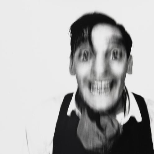

It just took a lot of practice. This is one of the earlier versions.
attachment.php
I honestly can't see why he would have revised this earlier one. I think this one shows more creativity as well as a hint of mystery.
