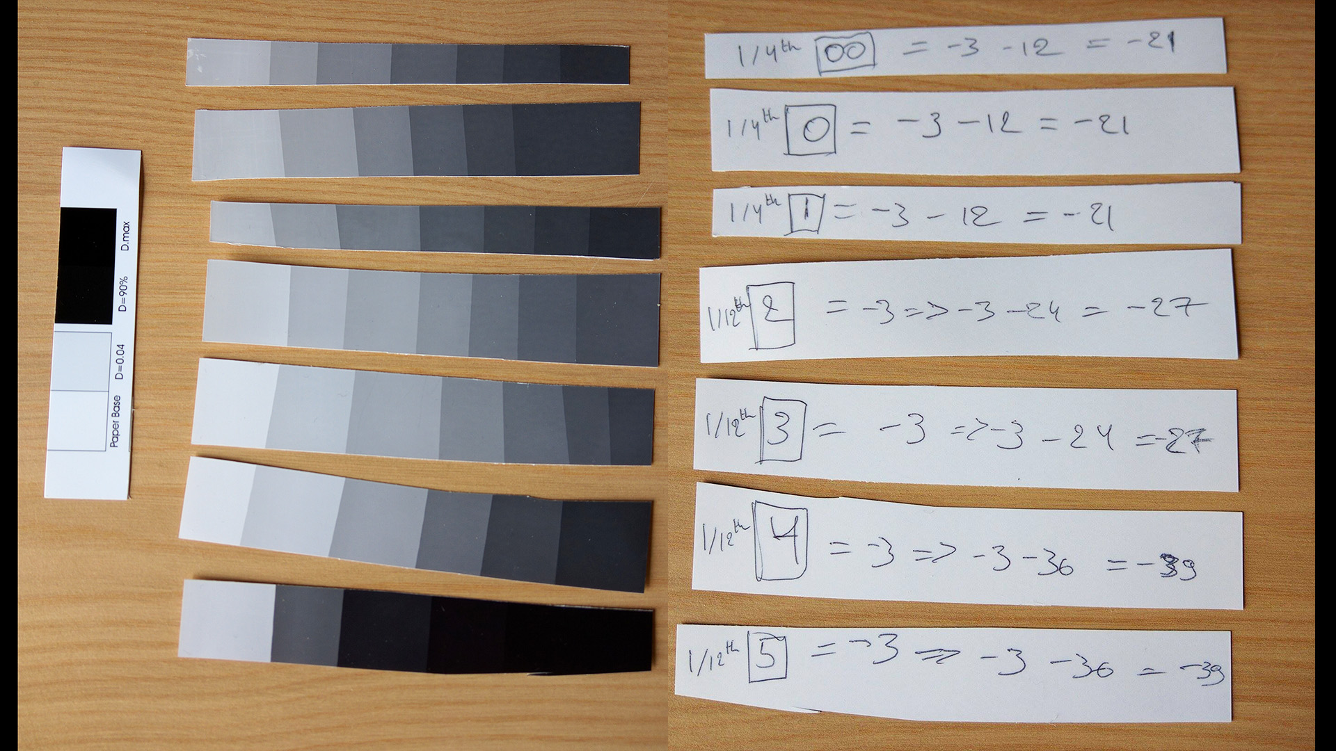

So I measured with the head at full height, no negative, no filter and smallest aperture (f45) and had to put it open to get an exposure between 10-20 seconds. This gave me 11 seconds on f11 grade 2 (on the screen)
So to start measuring exposure offset for 00 I put the analyzer on 00 (and also the enlarger) and the time decreased automatically. Then I started the teststrip mode, first exposure, not covering anything, second exposure covering 1/7th of the strip etc etc..
(see attachment) Got a teststrip... Was too dark, so I had to stop down the lens to f16 (note -1 stop). Then I got a teststrip that looked like the D=0.0.4.. However there were always slight differens, or not always perfect looking like it. So from grade two I switched to 1/12th instead of 1/4th for 00, 0 and 1. (note: I didn't always did the last test exposure, since it was too dark anyways).
So I had to stop down my lens quite a bit when I was increasing the grades:
0, 00 and 1 = -1 stops (measured at 1/4th)
2, 3 = -2 stops (measured at 1/12th)
4, 5 = -3 stops (measured at 1/12th)

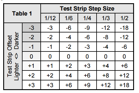

The exposure offsets
0, 00, 1 = -21
1, 2 = -27
4,5 = - 39
You can see my calculations at the right side of the attachment. As you can see, my offsets got quite ridiculous. Still however I continued and did the gradation control too. which I had a range from 60-15 (00 to 15) which is also ridiculous.. (I also had to put the column down because I was getting 130-200 second times to get the wedge dark at number 2 even at f5.6 and grade 00 which is wide open for my lens)
I made a few testprints and they were bad (ofcourse). So I put in channel 2 the settings that are suggested for the paper and made a testprint and almost looked okay instantly. However, it should be finetuned.
What did I do wrong? Should I have started with the default values delivered with the calibration manual or? It's really confusing since I read the manual so many times before I started and during the process. Strange thing is I had to stop down for EVERY exposure and every exposure was -3 off centre...

Found out that my user setting for test strip was in separate instead of incremental... Didnt know about this. This solved my problem. Still got big offsets (-18,-15 etc) but they work quite nice

If I remember correctly, you want to find the first off-white area to determine the offset.
First patch on your teststrips look quite dark already compared to mine. Do you get bright highlights on your positives?
My understanding of the system is, that the darkest spot measured on the negative will yield a print tone like the patch used to determine the offset.
