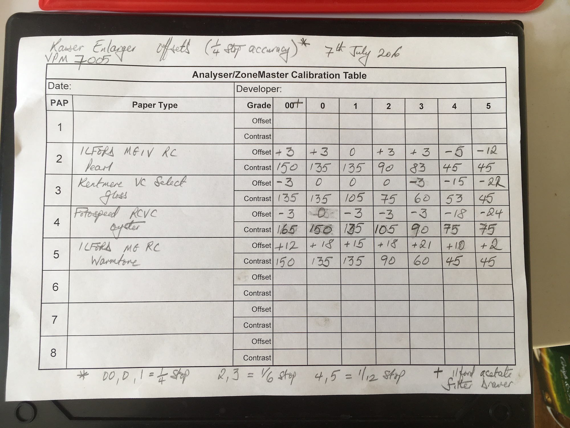

I have a Kaiser Multigrade head and an RH designs analyser. It is a tedious and laborious process to do the calibration but well worth it. For 00 you need to use an Ilford filter as the MG head only goes to 0. I’ll post my calibration data which should get you started.
Note that the numbers on your MG head 0,1,2,3,4,5 do not map exactly to Ilford MG filters. However, you do have continuous control of contrast -you can set intermediate values as you please. I have never had to make a print below setting 1.5 or above 3.5.

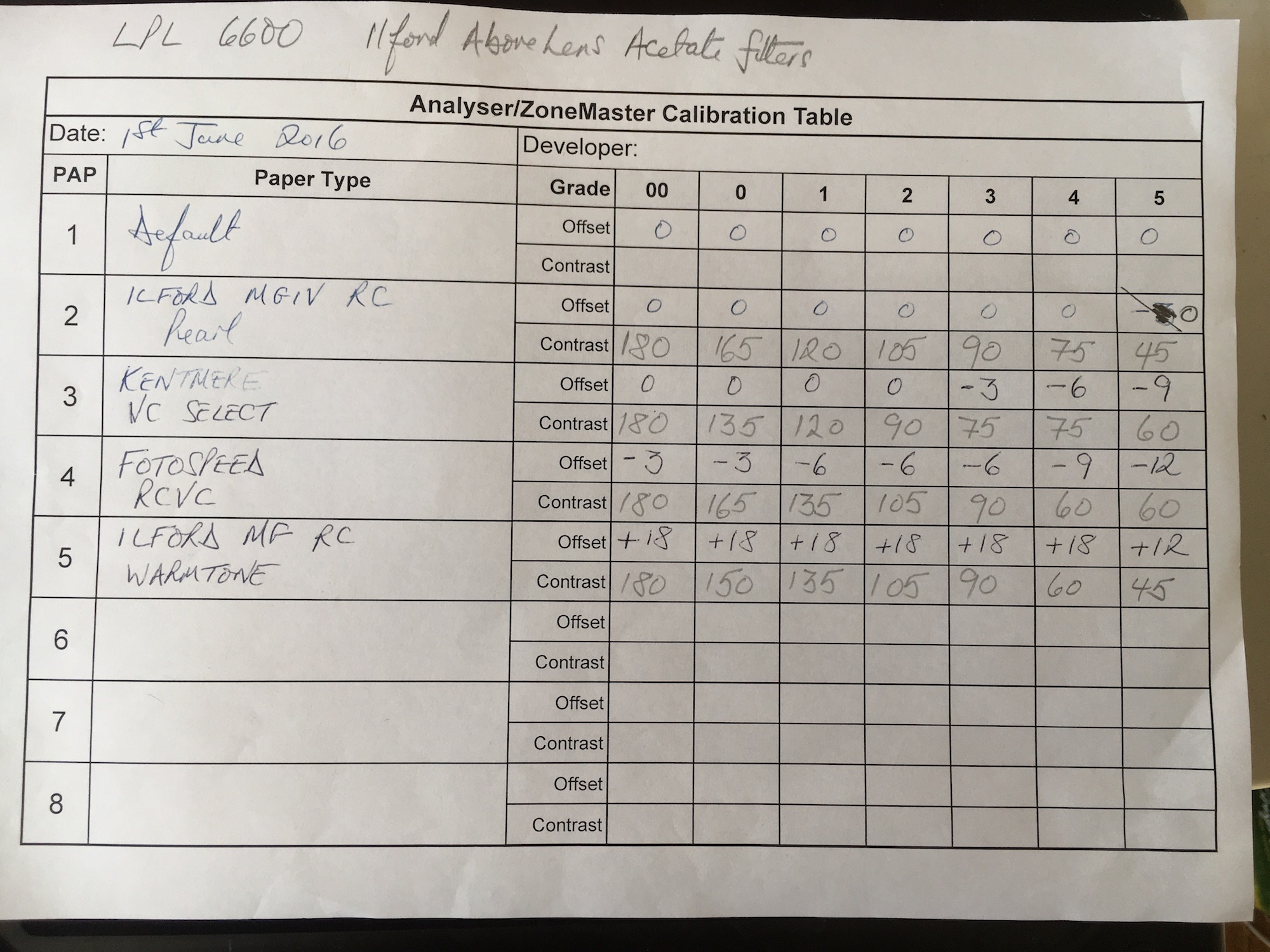

Here are some more figures for a different enlarger with Ilford above lens filters. This enlarger is a condenser with an incandescent light source (I have since sold this enlarger so I cannot comment further as I no longer have it).

Yes. My own calibrations with a condenser enlarger and Ilford multigrade above lens filters give figures very close to RH designs defaults. So close that there is not much difference. However, with a multigrade enlarger head my calibration figures are very different (which is what the OP is asking for).
You can see in post #7 that the offsets for MGIV are 0 across the grades (meaning there is no variance from the pre-programmed RH designs figures) but in post #6 for a multigrade enlarger with dichroic filters there is a big difference.
