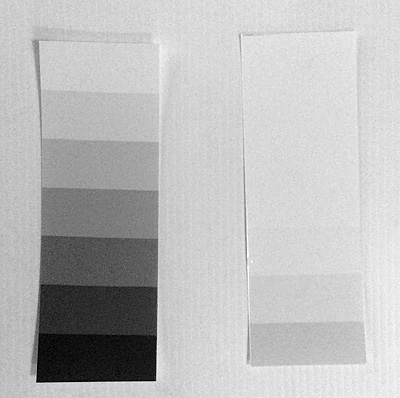

Just started my first full calibration using under the lens Ilford filters.
Exposure corrections, grade 00 to grade 3 were fine, for grade 4 and 5 the instruction book is a bit confusing, it says "If you are using a colour or VC enlarger, you will usually need to correct the exposure at grade 4 and 5. (I'm fully aware that 4&5 filters need double the exposure that lower contrast filters do) The next sentence says "This increase is built into the meter's basic calibration" and then it says "before you make the grade 4 test strip reduce the exposure setting by a full stop" so I reduced it by a full stop and did a test strip which seems too light, 4 steps are paper white, 3 steps have some tonality. I then went back to the original exposure and did a test strip which had 7 distinct tonal steps. The instructions seem confusing, am I supposed to change exposure or not? Note, both test strips have a step that matches the D-0.04 patch.
BELOW: Grade 4 test strips
LH strip exposed the same as grades 00-4, RH exposure reduced by 1 full stop.

I've done the full exposure calibration routine on mine (for MGIV and MG V RC paper) also using the Ilford filters. I think all the numbers you get during this process end up relative to the default calibration of the device, assuming you used an unadjusted paper channel when running through the routine. That being said, I don't recall making any unique grade-specific adjustments to my process.
I think what the instructions are trying to say, is that the exposure adjustments needed for the Ilford filters are already assumed by the device's default calibration. So if you're not using the Ilford filters, then you need to compensate by undoing that adjustment.

Thanks for the reply. I decided to start by testing MG RC IV thinking that if I didn’t need to make any adjustments I must be doing the tests properly, I could them move on to testing papers for which there are no numbers. So far I haven’t had to make any exposure adjustments from what was programmed into the unit.
I think your explanation is correct, using a color head you would need to make the adjustment but using below lens Ilford filters it would make sense that they would program the density difference into the program.

I started with MGIV for exactly the same reason. The adjustments I did make were relatively minor, and are likely due to either me being nitpicky with a densitometer or not 100% perfect in my developing process. If I was eyeballing it versus the sample, chances are that my corrections would have been less/different. I was probably more consistent in my process with the MG V paper, but that paper does respond differently (especially at the higher grades).
