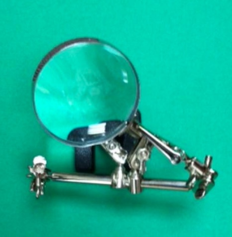

What might be helpful for you would be to get a gadget that will hold the parts for you. I have one but do not know what it is called or who makes it. It has a stand and adjustable arms that can accommodate alligator clips and a magnifying glass. All are on balls so they can rotate and be tightened in all directions. I bought it many years ago to hold small objects while I photographed them while needing my hands to be free for the camera. I'll try photographing it with my phone and put it in another reply.

Here's the gadget sorry for the photo quality it's an old phone and I wanted to reply quickly

Thank you! I will look out for it. But the main problem with me is that I'd much rather hold a one-inch glue stick in hand instead of 5 inches long piece of hot metal. The shorter the thing, the better the aim for me.

That "third hand" device shown above should solve all setting time issue.
I use it for soldering, not only as a third hand as such, but to keep flexible things steady during cooling as such can be critical at soldering too.
One may modify/substitute the clamps depending on the job.
I think my father had something similar years ago. I should ask him.
