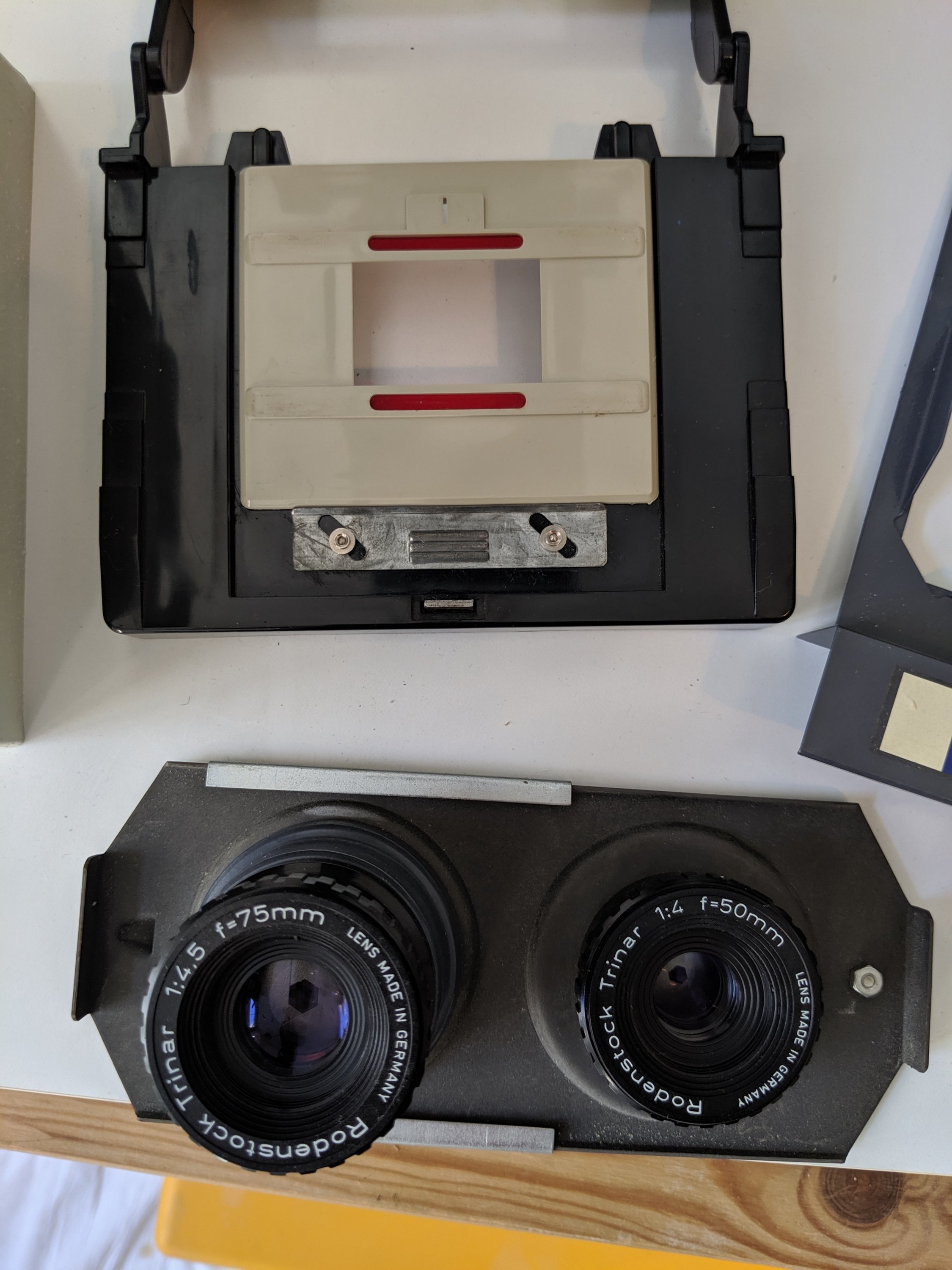

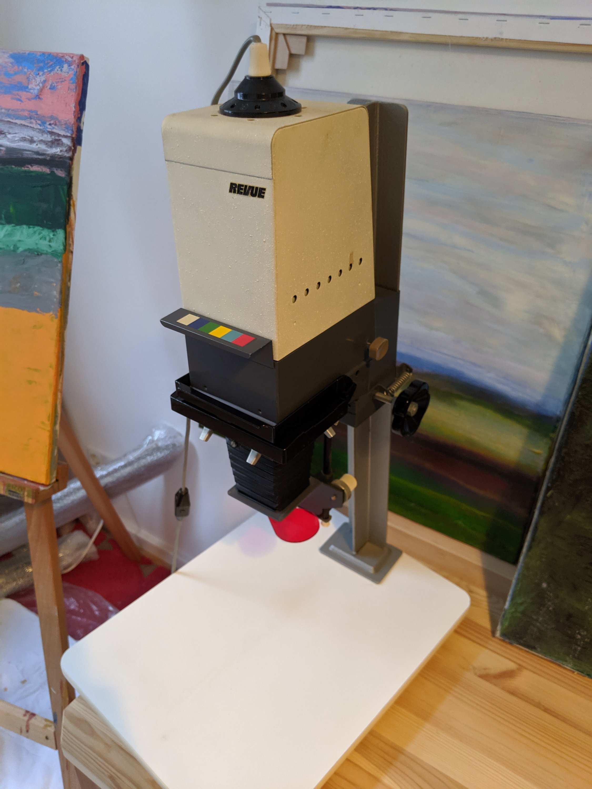

Here is the photo of Revue enlarger

The pictured enlarger looks a bit like the Krokus enlargers we sometimes see around here.

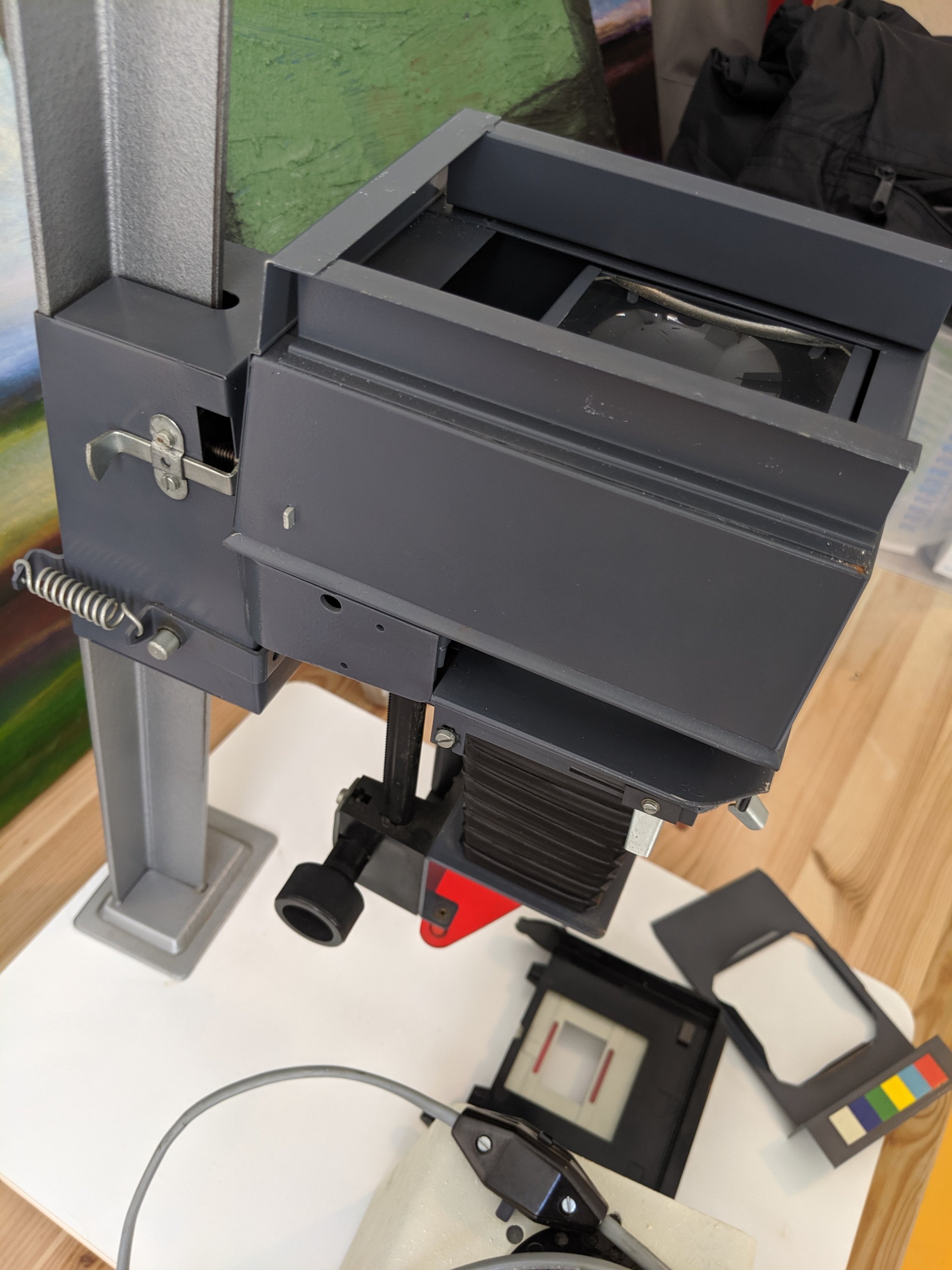

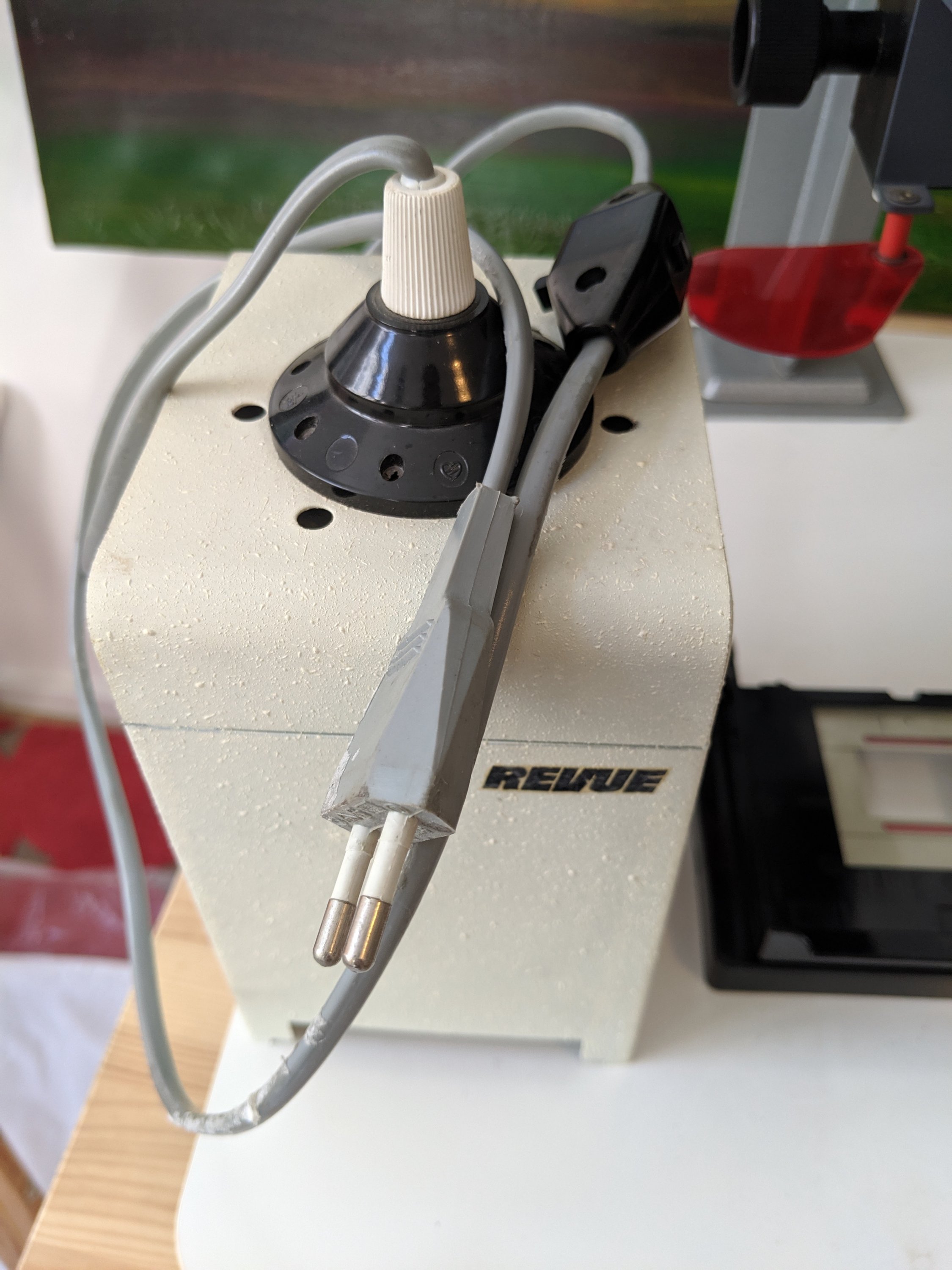

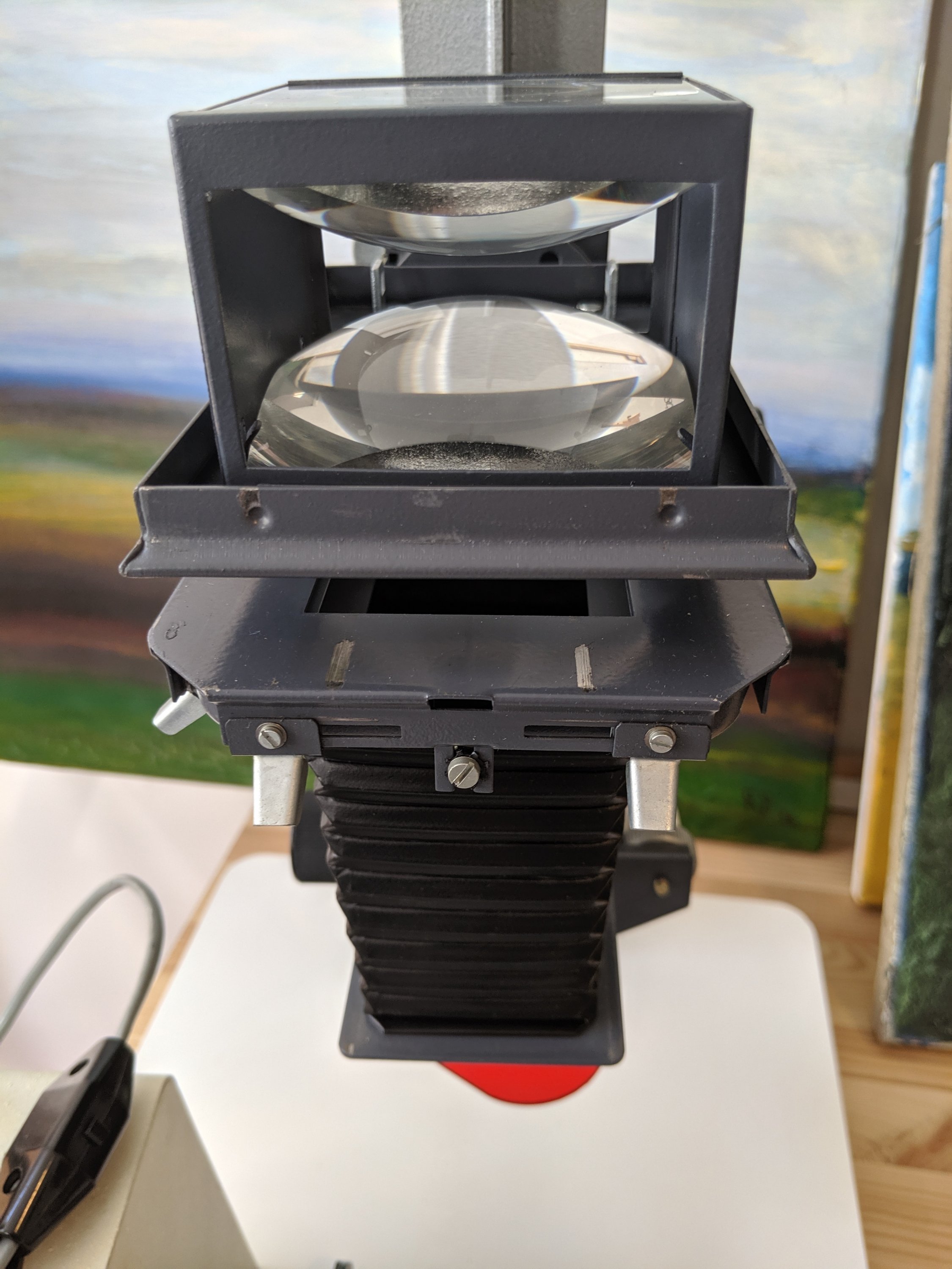

Can we see a photo of inside the enlarger, showing where the light source screws or plugs in, along with any appropriate measurements?

Here you go
