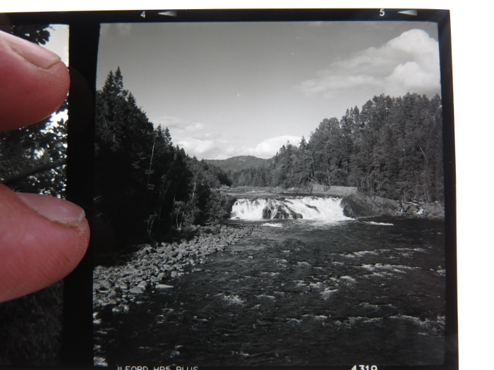

But if the final grain has little to do with the first developer, I'm actually quite happy with my exposure and first developing. Here is a jpeg from my Canon Powershot G15, unedited. The film was developed as per my original posting.
My primary dissatisfaction is, as I wrote, the final grain. Which I've been told is rather undependent on the first development(?)

A good question. I don't think I have projected HP5 in medium format yet. Under my Schneider 3x loupe it makes me want to do better. But it's not like the grain makes the photo unusable.
I think the first thing I will try is to just reduce the time for the second development. Maybe 10 minutes is more than needed for reaching dmax, and the last minute or two just builds up grain with no real gain in darkness?
