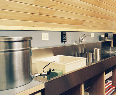

I built a s/s backsplash for my sink that is shaped like a 10x10-inch x 9-foot (length of my sink) 3-sided box. This is set to overlap the back side of the sink by 1 inch, to allow a 1-inch x 9-foot opening over my sink area. Just behind the sink is a 900 cfm exhaust fan on the outside wall, wired to a rheostat, which opens into the backsplash. The backsplash acts as a shroud to collect fumes from the sink area and duct them outside. The backsplash also serves as a flat area to mount the faucets.
Makeup air comes in high on the opposite wall through a fan/filter device used in wood shops. It also has a rheostat to control flow. I usually adjust the incoming flow slightly higher than the outflow, to slightly pressurize the room. Having excess cfm capacity, I can turn it up high to clear the room or for certain processes that create more fumes, and then turn it down to a whisper for other processes.
