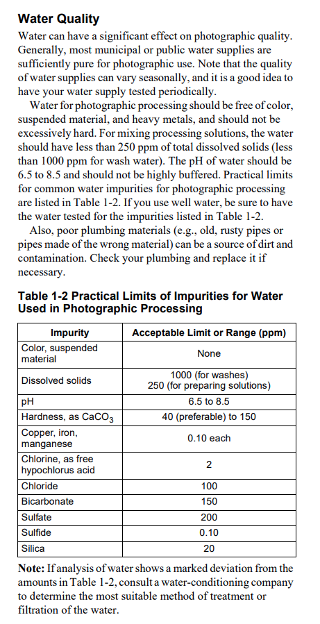

I am fortunate enough to have a good quality tap water that I use almost for everything, including color final rinses. I only use (cheap) deionized water for the BW final rinse, the product requires to not squeeze at all after the bath (Rollei RWA SC).
By the way, Kodak published some guidelines of water quality in the famous Z-131 document. The published analysis of my tap water complies with it.

Something else worth adding is that wetting agent concentration is specified for use with in-spec tap water (as per the Kodak documentation posted above by @halfaman ), not distilled water - which is something I've run up against in the past.
Outside of emulsion making and certain scratch-mixing (if you don't have certain sequestrants, and if those sequestrants aren't essential to the process - e.g. some B&W reversal or ascorbate developers) of process/ toning chemistry, distilled water should not be needed apart from for things like (possibly) print spotting etc.
